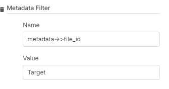

I’m using a Supabase Vector database to simply pull out 50 relevant search results that gets combined into a single string to be passed into DeepSeek which doesn’t have a built Tools functionality.
In the table that I’m actually trying to search the information with vector coordinates, there is a metadata->>[CATEGORY] that I’m trying to filter for BEFORE I get presented the 50 search results.
I can get Agentic RAG searches and filters through 3.7 Sonnet, buy asking for the filtering criteria connected through the Tools interface. We much prefer the writing style of the DeepSeek output.
Every combination and test of the Metadata Filter in the Supabase node results in 0 outputs. I can run the queries fine using SQL editor directly in the Supabase web interface.
If I remove the values, I get the expected 50 results. Then when I try the metadata filter, I get 0 results, even when I start copying and pasting directly from the results when there was no filter enabled.
I’m trying to filter by the file_id in the metadata (jsonb) column.
