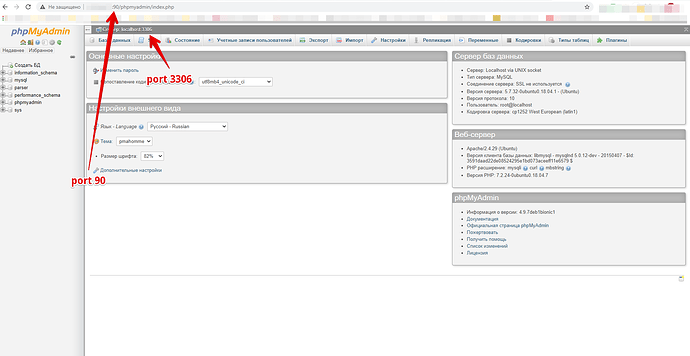

I specify in Credentials http://***********7:90/phpmyadmin/
and when Execute Node shows an error: “ERROR: getaddrinfo ENOTFOUND http://***********7:90/phpmyadmin/”

You have to specify as host exactly what you blurred out in the pictures. So, in this case, the IP address.

Hey @Roket!
Looks like the port that you have set is incorrect. On port 90 you’re running another service that is enabling you to access PHPMyAdmin. However, MySQL is not running on the same port (unless you have configured to run it on that port instead).
If you haven’t configured the port for MySQL, can you try using the default port in the MySQL credentials in n8n?
harshil1712, thanks for your attention to my problem.
I tried to specify port 3306, but it didn’t work, again an error.
Default MySQL port in n8n: 3306

Found such settings on the server (the server was not configured by me).
Host: localhost
Does this mean that I cannot access from the outside, for example, request via n8n?

You have a different host set up in your server while we are trying to connect with a different host. Since MySQL is not running on the host that you have configured in the MySQL node in n8n, we are getting the errors. You will have to update the host for your MySQL server.
And how to do it? I am not good at programming.
You have to change the value of the host with the value of the IP address. I would recommend you to checkout the MySQL Forum where you will get a detailed answer.
