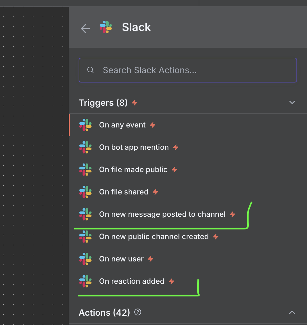

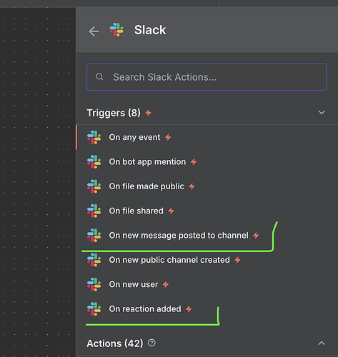

Hi there @Owen_Grant ,i think you can try either these 2 trigger
on reaction added is to watch for any reaction emoji to the message, and on new message posted is to watch for any “urgent” messages
you might need to do some filtering or put an if node to validate that the reaction and/or the message that you are looking for is the right type of message/reaction that you were looking for, since a user can send different types of emojis and different types of messages
