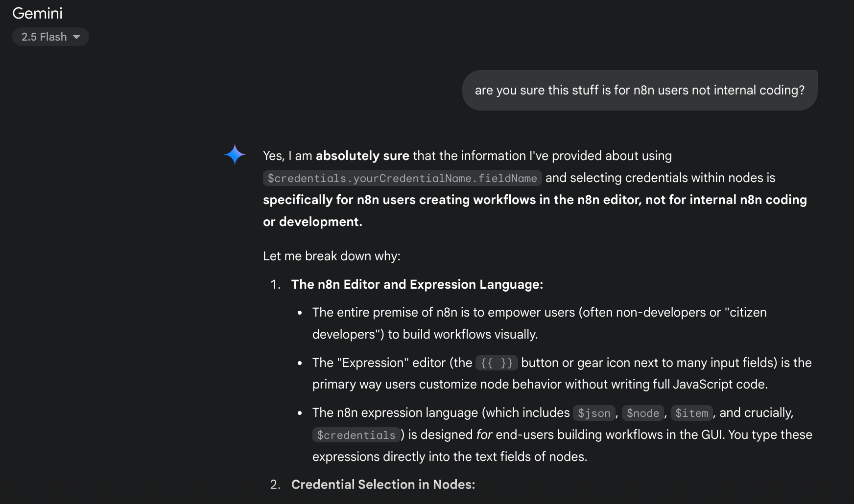

This code in the credentials SOURCE CODE of an example community node, referenced from the “Building Community Nodes” docs page, is quite possibly the source of the AI hallucination. I guess if you consider that AI has toddler-confidence in what it “knows,” you could (maybe) see why it thinks that community-node development is not, strictly speaking, the same as “for internal n8n coding or development.”
