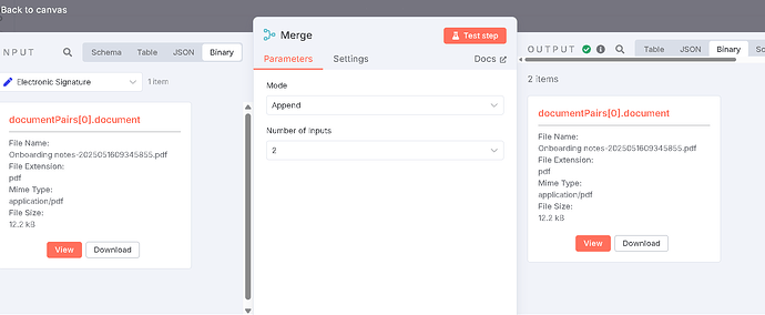

Hello @Erick_Torres & @mohamed3nan

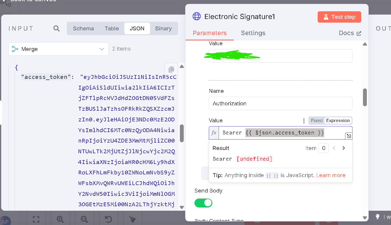

Thank you both for the support, unfortunately my version does not have Pass-through option only: append, combine, sql query and choose branch. With the option append i managed to get both “file and token” . However, for some reason when i use expression to get the access_token from the merge node to the service http node it says “Undefined” like no value is coming(even though i can see the token generated)
Few photos attached.

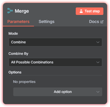

Hi @Jose_Pachon
Use the Merge with Combine mode and All Possible Combinations
There you go! @mohamed3nan thank very much for your help!
