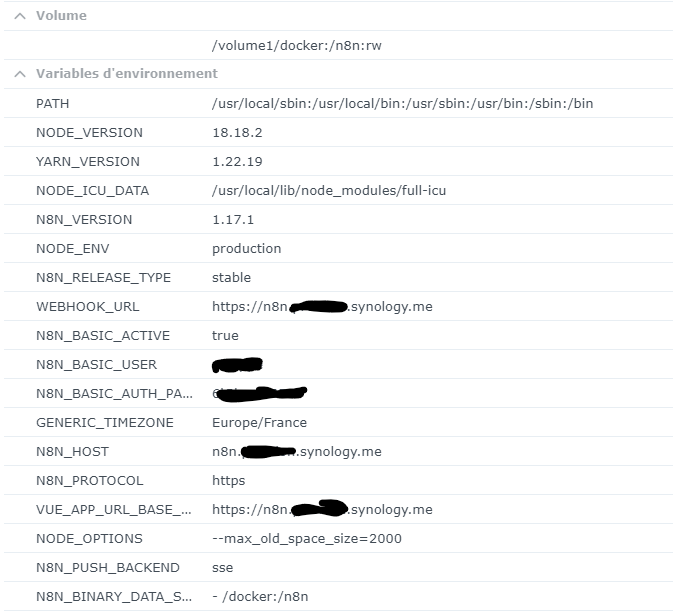

Thanks @Jon for your answer and sorry for not getting back before… Lot of work at the moment.
Before moving to container manager my configuration was working fine…
This is below my configuration.
Do you see what I missed?
Many thanks in advance!
Philippe
Hey @Philippe,
The Volume needs to be pointing to /home/node/.n8n not /n8n which would explain why your data is going missing.
You can also remove N8N_BASIC_*, VUE_APP_*, I would also double check what N8N_BINARY_DATA_S is as that could be wrong as well.
