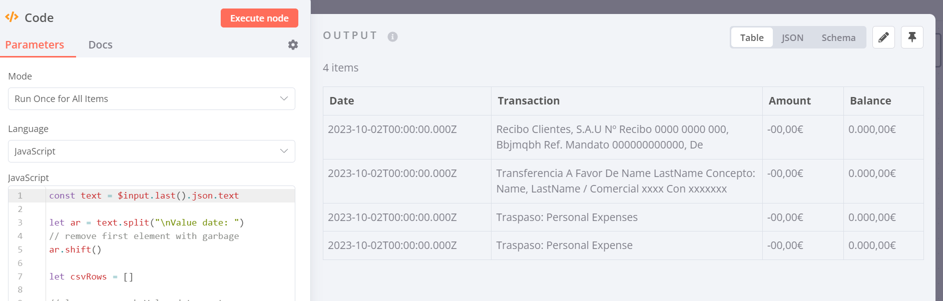

I do not have google account, but suppose that should work (if the sample is correct)
example output
Pretty close, but not perfect :wink:

try this one (it is more complex as it uses regex, but maybe it will act better)
In general, that request is not about javascript itself, it is rather about data manipulation and working with strings.
