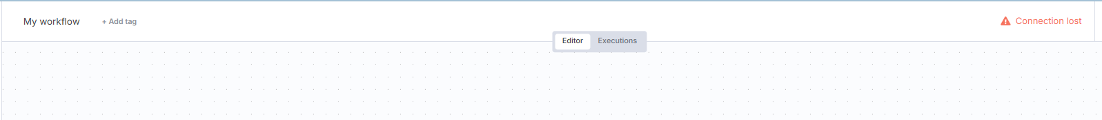

Hi,
I’m facing an issue with the n8n UI when running the self-hosted community version (n8nio/n8n:1.89.2) on EKS. However, if I use kubectl port-forward to access the service, the UI works fine without any issues.
I’m using an Ingress to expose the service. Below are some of the environment variables I’ve tried setting, but the problem still persists:

Hey @kartikm
Your need websockets enabled, am not 100 percent sure on k8s, but after some searching something like this:
apiVersion: networking.k8s.io/v1
kind: Ingress
metadata:
  annotations:
    nginx.ingress.kubernetes.io/proxy-read-timeout: "3600"
    nginx.ingress.kubernetes.io/proxy-send-timeout: "3600"
    nginx.ingress.kubernetes.io/proxy-http-version: "1.1"
    nginx.ingress.kubernetes.io/connection-proxy-header: "upgrade"
    nginx.ingress.kubernetes.io/websocket-services: "<your-n8n-service-name>"   # Optional but helps with older nginx-ingress
    nginx.ingress.kubernetes.io/enable-websockets: "true"                       # Sometimes needed
Similar issues with dockers nginx Connection lost" after upgrade to n8n 1.98.1 using Docker + Nginx (Ubuntu 24.04)
Hopefully that does the trick for ingress, and can help look into the enc key after this too if you’d like.
I know dockers quite well, still touching up on k8s so happy to explore and learn more too :slight_smile:
Samuel
Hi @King_Samuel_David
I have tried above configuration , but getting with below error.
Failed to save resource: (BadRequest) admission webhook “validate.nginx.ingress.kubernetes.io” denied the request: annotation nginx.ingress.kubernetes.io/connection-proxy-header contains invalid value
nginx.ingress.kubernetes.io/connection-proxy-header: “upgrade”
Getting error for this annotation , if i use keep-alive still same error connection lost
