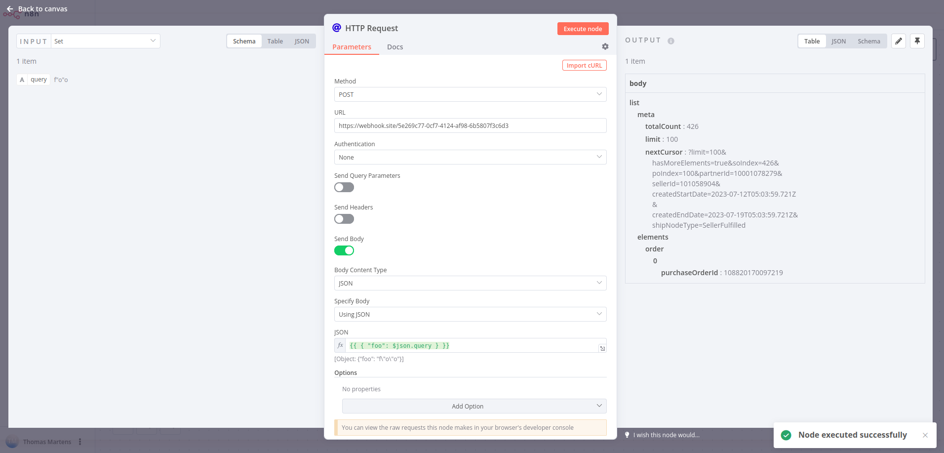

Hi @wilsoncelyCUC :wave: Welcome to the community! :tada:
First and foremost - I wanted to let you know that you accidentally shared an API token in your workflow details code block, which I’ve redacted for you. But you might want to rotate your API keys :see_no_evil:
I have a feeling you’re going to want to return a single JSON object, like this:
"queries": $json["query"],
"countryCode": $json["country"],
"includeUnfilteredResults": false,
"languageCode": $json["language"],
"maxPagesPerQuery": 1,
"mobileResults": false,
"resultsPerPage": $json["nb_profiles"],
"saveHtml": false,
"saveHtmlToKeyValueStore": false,
"maxConcurrency": 10
They way you’re currently returning the object is a string within a string - when you wrap the expressions in quotes like { "foo": "{{$json.query}}" } it will return only text, but if you return {{ { "foo": $json.query } }} it will be the actual JSON object, which is what you’re going to want :slight_smile: When you start an expression with {{ and end it with }} n8n considers the whole expression to be JavaScript, so quotes inside a field like $json.query would be properly escaped.
Something like this will work, and you know you’re on the happy path if you see that little "Object: " bit in front of the preview of your expression:
Let me know if that helps you out!
Thanks! Im so rookie :slight_smile: Ive rotated my key
As per the issue, Indeed, it worked fine with your solution… and your explanation was straight-forward ,so big thanks!
Have a great week!
