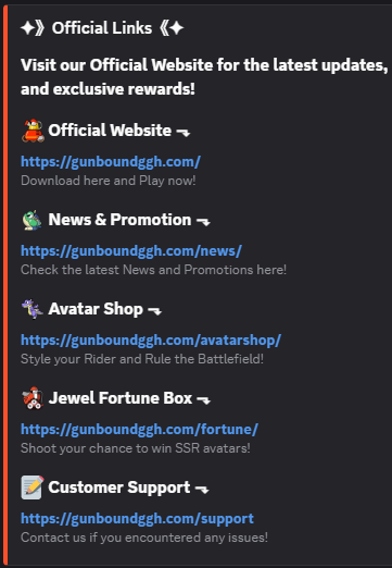

I need something like this product name and link, remembering that the code can return 1 or more products.

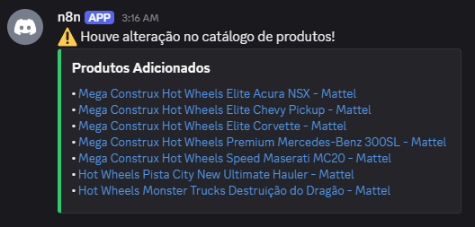

Here’s the working version of the workflow:
I hope this helps resolve the issue!
Thank you so Much, this helped me alot!! Have a nice day!!
