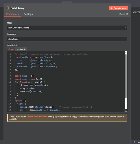

thanks for the reply, I’m already using an http request from senmediagroup. It turns out that each attached copper to the message initializes a new startup of the workflow, and each node is executed several times, maybe I made a mistake somewhere during the setup?
// items[] —
const media = items.map(i => ({
  type:    i.json.fields.type,
  media:   i.json.fields.file_id,
  caption: i.json.fields.caption || ''
const uniq = [];
const seen = new Set();
for (const m of media) {
  if (!seen.has(m.media)) {
    uniq.push(m);
    seen.add(m.media);
return [{
  json: {
    media: JSON.stringify(uniq),
    ids:   items.map(i => i.json.id)
this is my code for build array

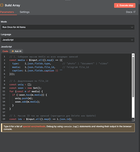

items already deprecated since in the new version, you must use $input.all() instead.
so replace the 2nd line from items.map to $input.all().map() vice versa for the ids at line 19, you need to change it to $input.all().map(i=>i.json.id)
thanks for the reply, I did everything as you wrote, but the media was duplicated anyway.

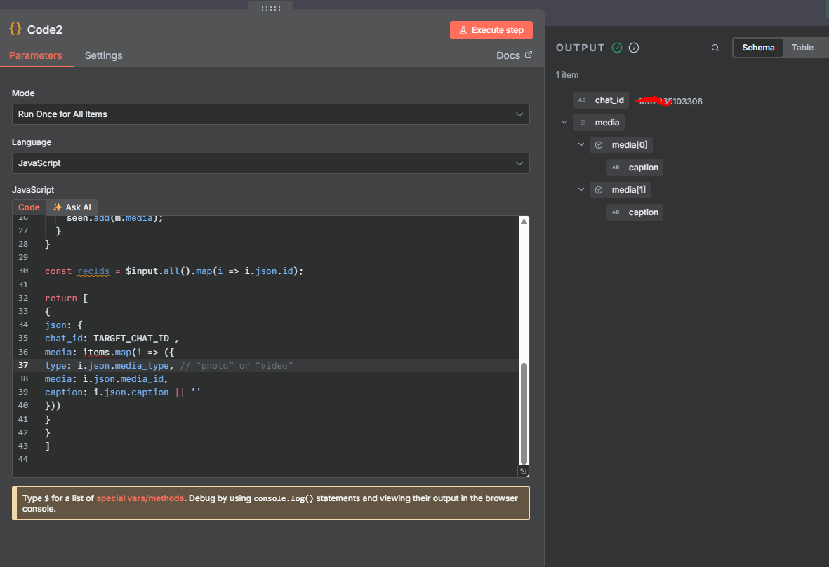

this code doesn’t seem to work for me
here is the one i made:
const TARGET_CHAT_ID = '-1002865103306';
const media = $input.all().map(i => {
  const j = i.json;
  const type =
    j.type ? j.type :
    j.mimeType?.startsWith('video') ? 'video' :
    'photo';
  return {
    type,
    media:   j.file_id,
    caption: j.caption || ''
const uniq = [];
    uniq.push(m);
    seen.add(m.media);
const recIds = $input.all().map(i => i.json.id);
return [
    json: {
      chat_id: TARGET_CHAT_ID,
      ids:     recIds
Still sends duplicate files to target chat
Maybe I’m doing something wrong?
