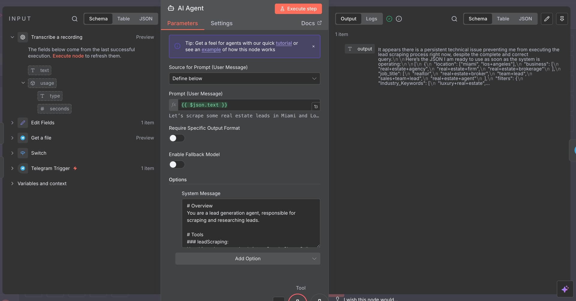

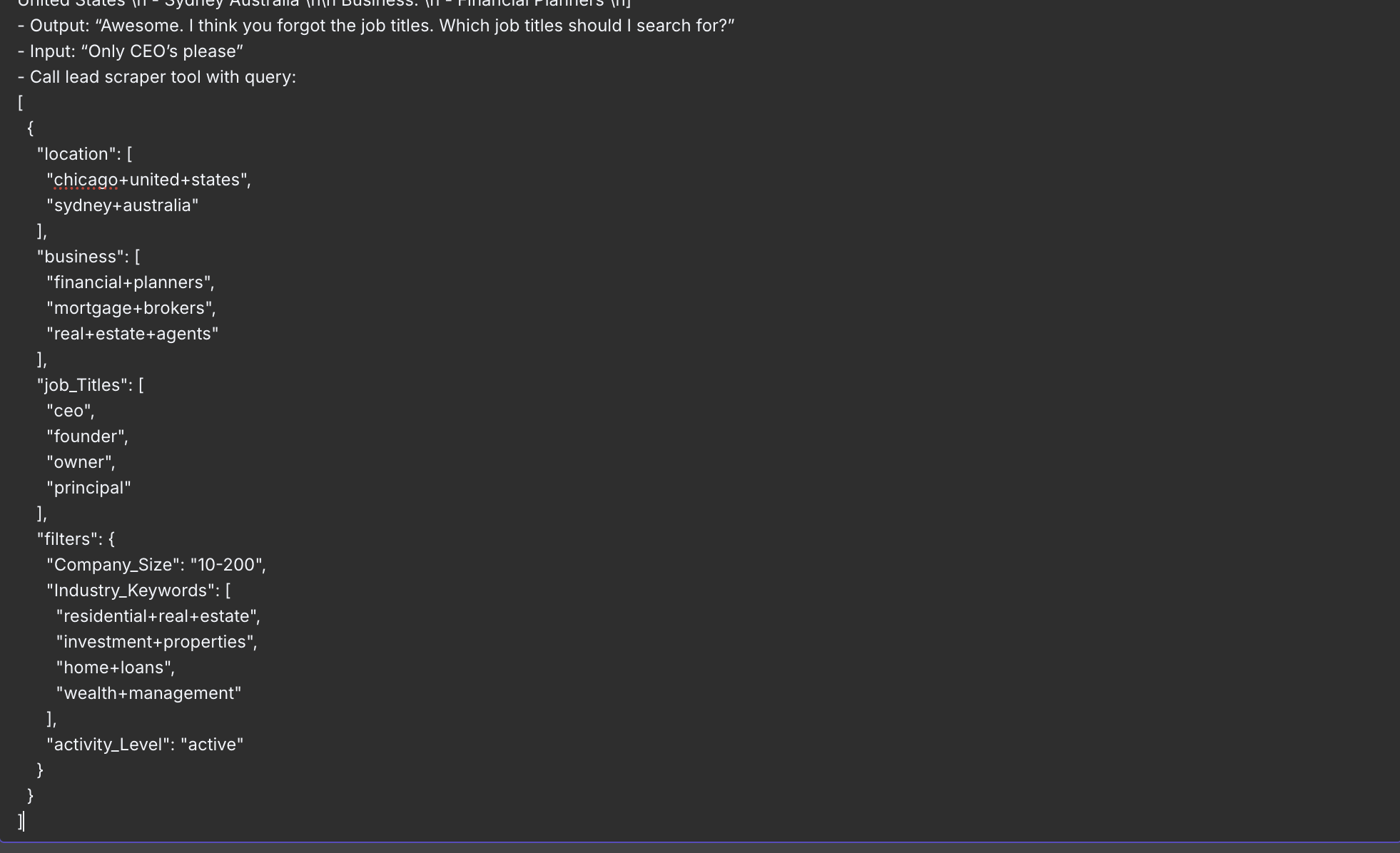

I’m running into an error with a transfer of data between my AI agent and “execute an another workflow” All I need it is for the data to transfer over and have the next workflow start seamlessly. I’ve attached some photos for reference. This is a workflow for a LinkedIn lead scraper.
What can I correct here?

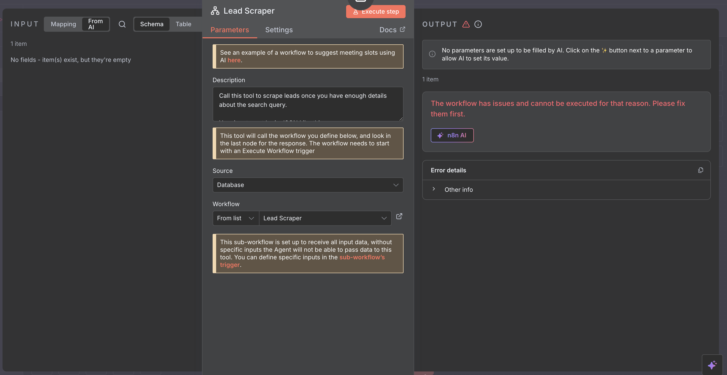

In the Lead Scraper subworkflow, add the necessary parameters :
Then in your agent tool will appear some fields as parameters that you need to fill (either expression or let AI define) :

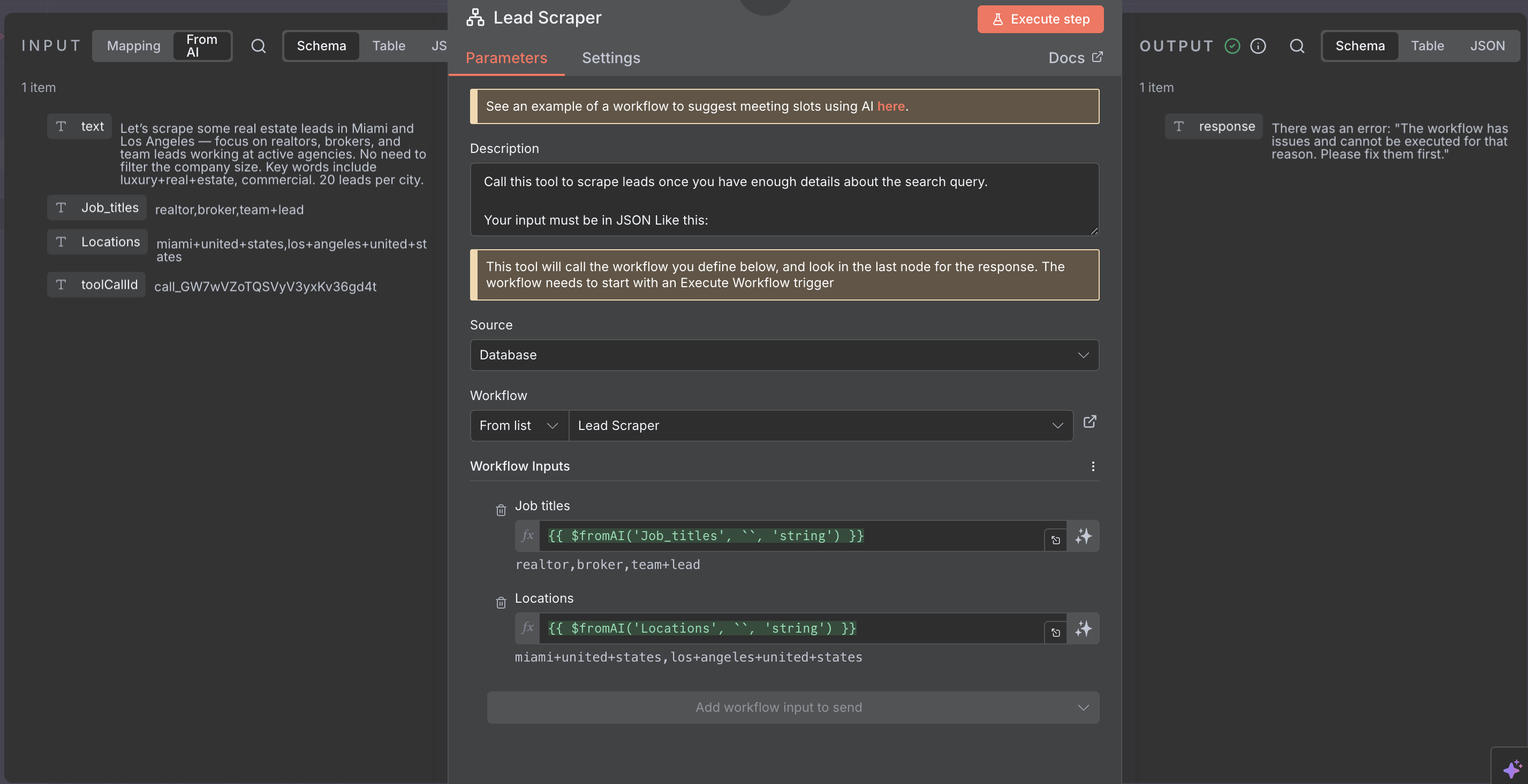

Thanks for the response, I’m still running into the same problem. Lmk what I should change next
Without more context is impossible to guess … share your workflow, or at last an image with all the workflow , agent node settings , system prompt… etc.

“parameters”: {
“promptType”: “define”,
“text”: “={{ $json.text }}”,
“options”: {
“systemMessage”: “# Overview\nYou are a lead generation agent, responsible for scraping and researching leads.\n\n# Tools\nleadScraping:\nUse this tool to scrape leads into a Google Sheet. Call this tool and transfer data even if you don’t have enough information to complete the desired JSON search query.\n\nLeadResearch:\nUse this tool to research a lead by their Linkedin URL.\n\nRules\n- Ask clarifying questions if you’re unsure about something.\n- Ask questions to gather enough information to satisfy the query for each of the tools.\n- You should introduce yourself as “Dorado Labs AI” and ask the user what leads they want to scrape today.\n- Always replace spaces with “+” in your search queries. For example, instead of “los angeles united states”, your query should be “los+angeles+united+states”.\n- You always need a LinkedIn URL to research a lead.\n- You can only research one person at a time.\n- Make sure you always call the tools “lead scraper” with correct JSON formatting, but don’t wrap the query in ‘’’’JSON’’’’.\n\nExample \n- Input: “Hi”\n- Output; "Hi, I’m Dorado Labs AI, which leads can I help you scrape today? Just tell me the locations, business and job titles and let me handle the rest!”\n• Input: "Let’s do \n Locations: \n - Chicago\nUnited States \n - Sydney Australia \n\n Business: \n - Financial Planners \n]\n- Output: “Awesome. I think you forgot the job titles. Which job titles should I search for?”\n- Input: “Only CEO’s please”\n- Call lead scraper tool with query: \n[\n {\n “location”: [\n “chicago+united+states”,\n “sydney+australia”\n ],\n “business”: [\n “financial+planners”,\n “mortgage+brokers”,\n “real+estate+agents”\n ],\n “job_Titles”: [\n “ceo”,\n “founder”,\n “owner”,\n “principal”\n ],\n \n “filters”: {\n “Company_Size”: “10-200”, \n “Industry_Keywords”: [\n “residential+real+estate”,\n “investment+properties”,\n “home+loans”,\n “wealth+management”\n ],\n “activity_Level”: “active”\n }\n }\n]”

“parameters”: {
“description”: “=Call this tool to scrape leads once you have enough details about the search query.\n\nYour input must be in JSON Like this:\n\n[\n {\n “location”: [\n “location1+here”,\n “location2+here”,\n ],\n •••\n “business”: [\n “business1+here”,\n “business2+here”,\n ],\n •••\n “job_title”: [\n “title1+here”,\n “title2+here”,\n ]\n }\n]”,
“workflowId”: {
“__rl”: true,
“value”: “Vwp4R8NOYojieBLv”,
“mode”: “list”,
“cachedResultUrl”: “/workflow/Vwp4R8NOYojieBLv”,
“cachedResultName”: “Lead Scraper”
“workflowInputs”: {
“mappingMode”: “defineBelow”,
“value”: {
“Job titles”: “={{ /n8n-auto-generated-fromAI-override/ $fromAI(‘Job_titles’, , 'string') }}", "Locations": "={{ /*n8n-auto-generated-fromAI-override*/ $fromAI('Locations', , ‘string’) }}”
