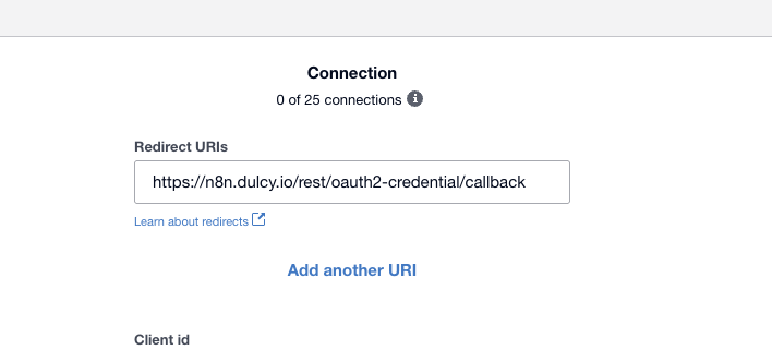

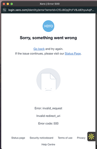

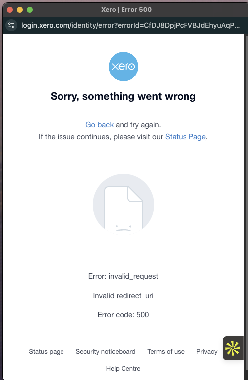

I am trying to connect my Xero for over 7 hours now.. I am running into this issue where i believe is caused by my redirect URL. I have changed everything in coolify to have https in front of it but it still returns the URL without it and when i put it into xero it says i have to have https. i also tried to reconnect my google sheet and i get blocked. I am stumped at what to do and feel like ive tried everything. Any ideas?

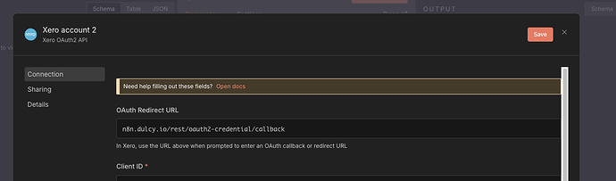

Hello @Dulcy, welocme!
Looking at this screenshot, there’s something I noticed right away,
The OAuth Redirect URL is missing the https:// which makes me suspect there’s a configuration issue.
since you’re using Coolify, are you sure the settings in your Docker Compose are correct?

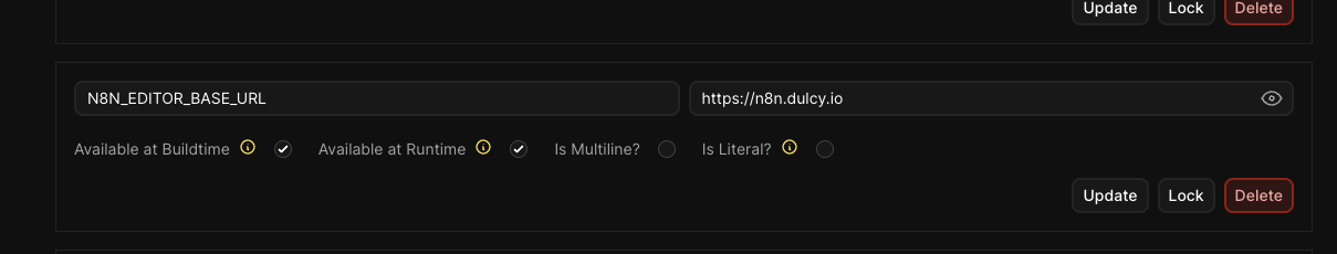

Thank you for the quick response and trying to help. This is where im confused because in Coolify I have it like this:
what about these:
N8N_HOST
WEBHOOK_URL

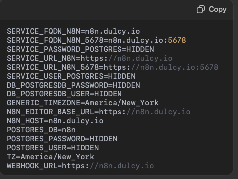

If you can share your compose and env variables (with sensitive information redacted), I can compare them with mine.
Here I hope this helps:
nice, thanks
edit these:
N8N_EDITOR_BASE_URL=${SERVICE_URL_N8N}
N8N_HOST=${SERVICE_URL_N8N}
WEBHOOK_URL=${SERVICE_URL_N8N}
What do you mean?
I made the change and still the same no https in the redirect url
Can you attach your compose, or does it look like this?
The coolify environmental variables weren’t updating in the Docker Compose. I got it now thanks
