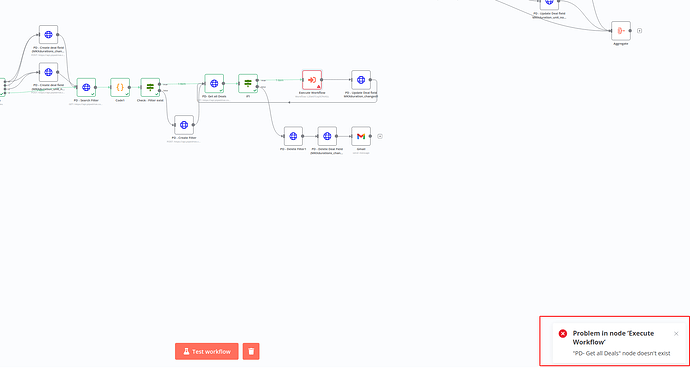

Hey thank you again for your help. The subworkflow sounds like a good solution and should do whats needed. But somehow I do not get any data in the subworkflow? I thought I put this module
and everything which happen so far in the previous nodes should be passed to this node?
but it seems not since I get that error message
How can i pass the data to the subworkflow?
OK I got it. In the node after “Execture Workflow Trigger” I have to use the data like $json…
But It seems this node does only get the data from the previous node and not from all the other nodes. I could I pass the data from the trigger node into the subworkflow?
you could merge in the data from the trigger node before the “execute wf” node.
Or you add the data using the code node.
(the sample code in the code node gets you half there)
edit: the easiest path should be to add an edit node

the Edit Fields node is intended to run before the execute Workflow node. Thereby appending the data (token) to each item before sending it to the child workflow.
The child workflow should only have the data, not a refference to the previous wf.
