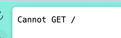

The thing is: its working everytime i try it - but, when i have a few days not visited the n8n site then its stopping the service.
When i then access the website again, i see just a “Cannot GET /” text on a blank white screen.
Then i have to refresh the site once again and its working for a few hours again.
Where can i find the solution for this issue? can you guide me through the debugging?
Best, David

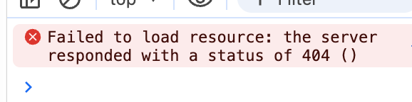

Error:
Console:

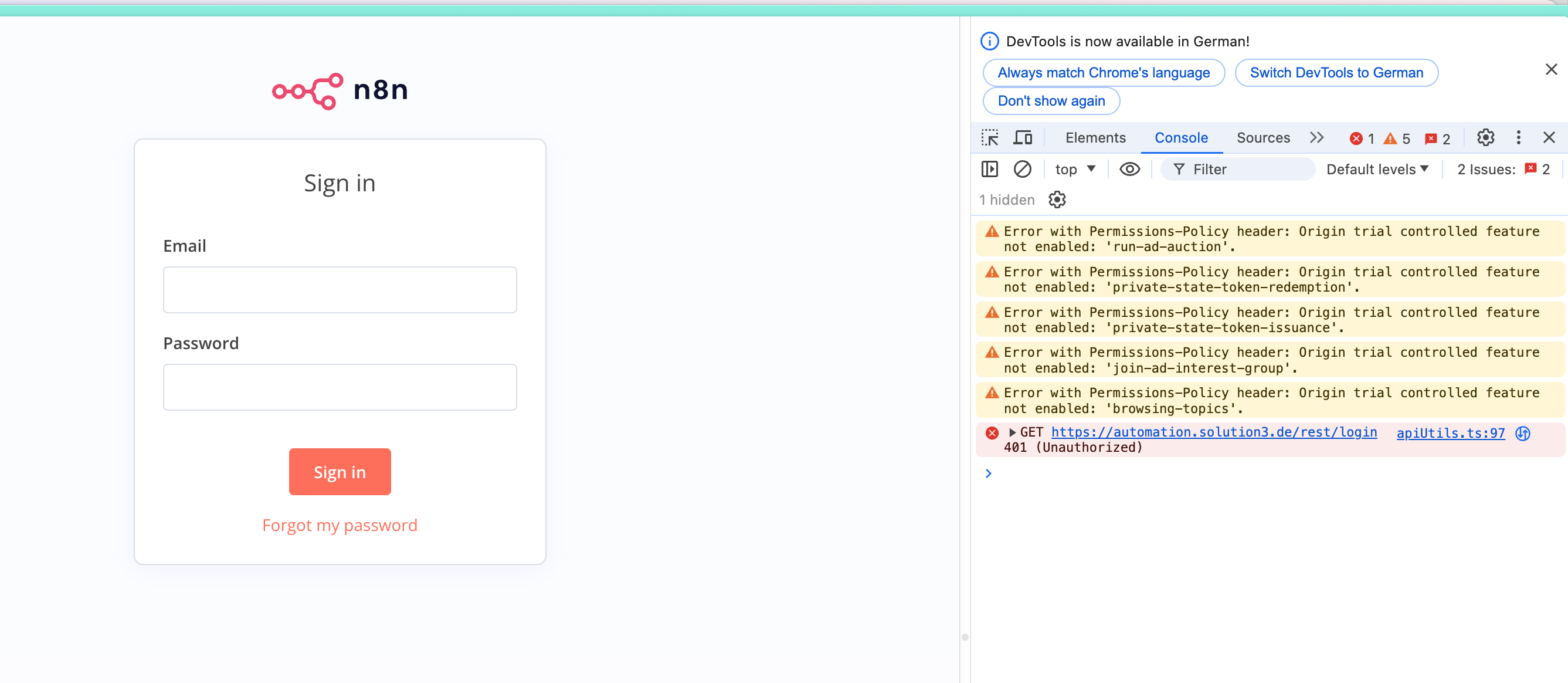

Favicon looks great. After refresh, console + loginscreen and all working:
hello @davidhaller
I suppose the issue is with your session cookie, which have expired, but the n8n didn’t return to the login screen (usually that happens if the n8n tab was in the sleep state). So when you have clicked on the refresh button, you started to be re-authenticated and everything starts to work fine
yeah, that should be okay for me, but the problem is that it looks like all automations are paused in this state… when i refresh it and my trigger detects a email in the inbox it works perfect directly. but not without refreshing the tab.
That should not happen with n8n itself. Do you have any logs related to the n8n?
