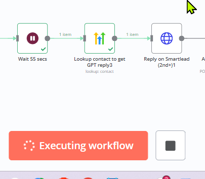

Hi Mariana thanks for the reply.
So yes let’s say I’m testing a workflow, I proceed to the next step and it creates an output.
Then it just stays stuck on Executing workflow and I can’t do anything except refresh and start again from wherever it was pinned. You can see the symbol spinning in screenshot as if it is still waiting.
Also happens on different types of nodes for example GHL update contact or Airtable nodes doesn’t seem to care which node.
Happens randomly and on different workflows making it 10x more difficult to do anything. Any ideas please?
