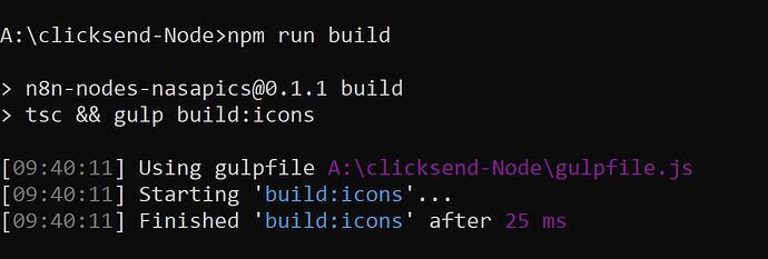

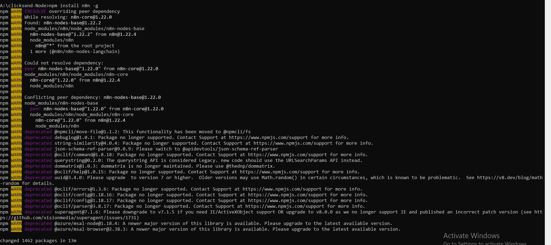

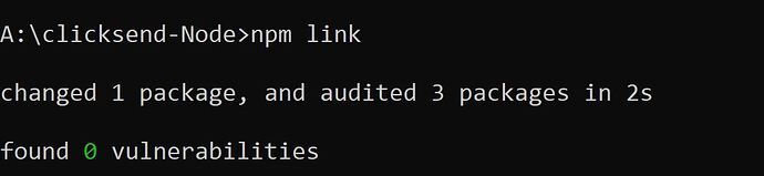

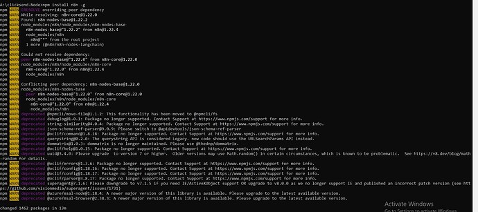

here is the screenshot of my all running command and their results.
why this happen we are worried that i follow all the same step according to documentation and also complete all step. there is no error in code there is no error comes from any other command that we run during the process but when i run finally command and want to start our node they give me this type of shit error. we are not add any piece of code from myself all code and method according to documentation. if the officially documentation not working fine then how a developer can build a new node for his own service and also for community use.
if you have any other support medium/channel kindly tell me. support on google video call voice call and any other. we get n8n subscription for developing node but we are still not able to do any thing and we pay for subscription every month.
kingly its my request help me in this issue if you can.
Thanks

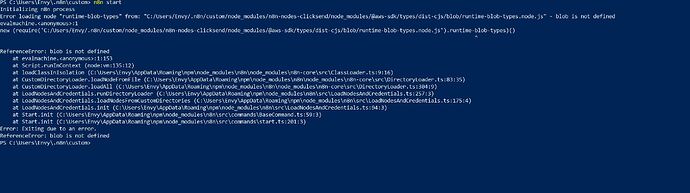

Hey @Waqas_Shaukat,
I believe the issue you are seeing there is down to an issue with the AWS-SDK package, I have seen a lot of reports of it failing from Windows but I have not yet seen a fix. I will see if I can do some digging into the AWS-SDK repo and see if they have fixed it yet.

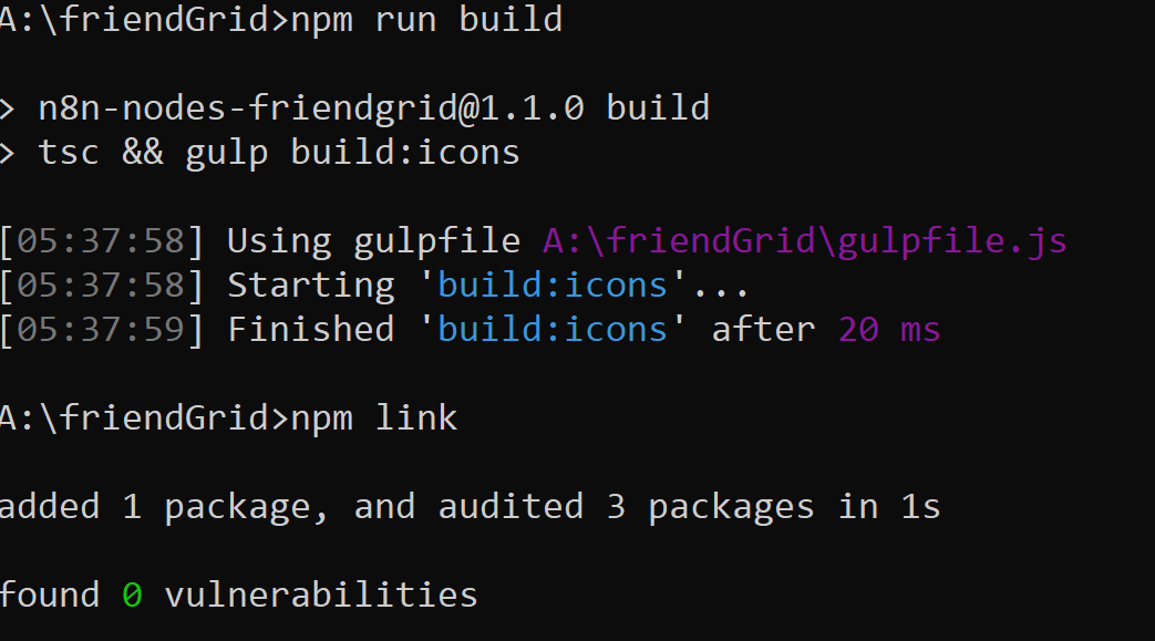

Hey @Jon
i resolved all the error and bugs

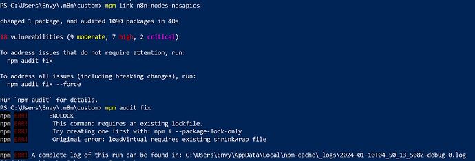

Hey @Waqas_Shaukat,
You don’t need to run npm 1 in the custom folder but it looks like doing that has removed a package so you added it with npm link then in the next command removed it.

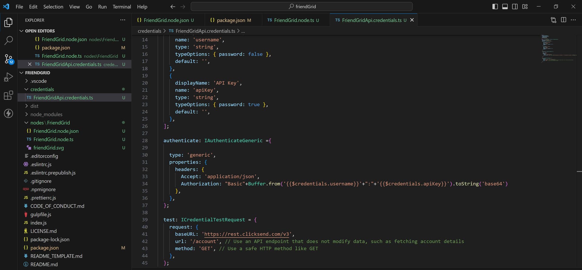

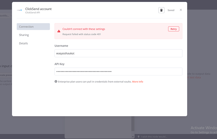

Now i face a new issue.

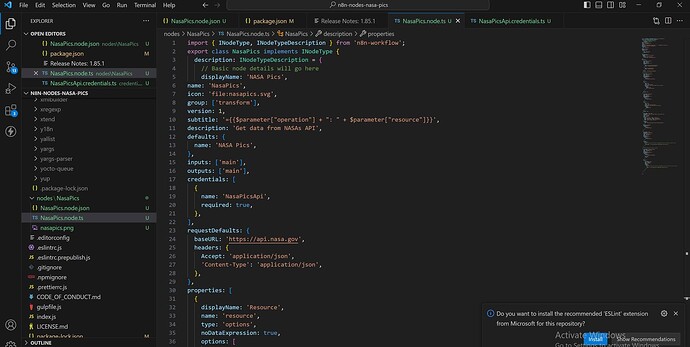

according to credentials file structure and documentation we can get GUI Node Input parameter by
‘api_key’: ‘={{$credentials.apiKey}}’
Hey @Waqas_Shaukat,
I would try using a different test url so you can see what the data is that you are sending, Looking quickly at your code I suspect you could be missing a space between Basic and the base64 encoded data, It also looks like you might be encoding the wrong values as well.
I would probably use the below which should take care of it for you.
authenticate: IAuthenticateGeneric = {
type: 'generic',
properties: {
auth: {
username: '={{$credentials.username}}',
password: '={{$credentials.apikey}}',
Hey @Jon,
you mean using this will automatically add “Basic” and also convert the username and Apikey into base64 string ?
Hey @Waqas_Shaukat,
That is my understanding.
Hey @Jon
Thank you it is working for me.

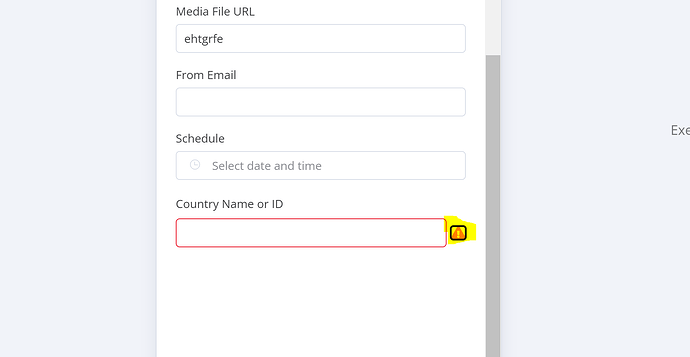

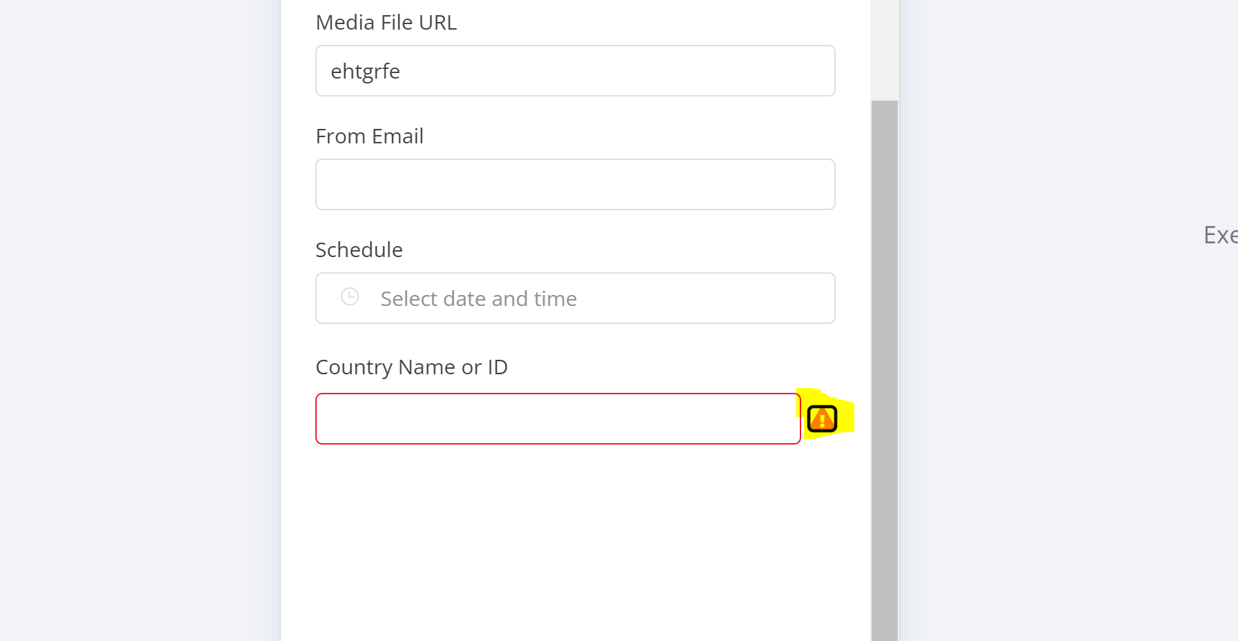

Hey @Jon
i used loadOptions but we getting some error.
displayName: ‘Country Name or ID’,
type: ‘options’,
description: ‘Choose from the list, or specify an ID using an’,
noDataExpression: true,
options: ,
default: ‘’,
typeOptions: {
loadOptionsMethod: ‘country’,
displayOptions: {
show: {
operation: [‘send’],
resource: [‘fax’],
//function
async country(this: ILoadOptionsFunctions): Promise<any> {
const returnData: any = ;
const optionsForCountries: OptionsWithUri = {
headers: {
Accept: 'application/json',
method: 'GET',
uri: 'https://rest.clicksend.com/v3/countries',
json: true,
const countriesResponse = await this.helpers.request(optionsForCountries);
console.log(countriesResponse);
for (const country of countriesResponse.data) {
returnData.push({
value: country.code,
return returnData;
here is my code.
and this error :Issues:
There was a problem loading the parameter options from server: “Node type does not have method defined”
Where have you put the country function is it under the nodes methods?
