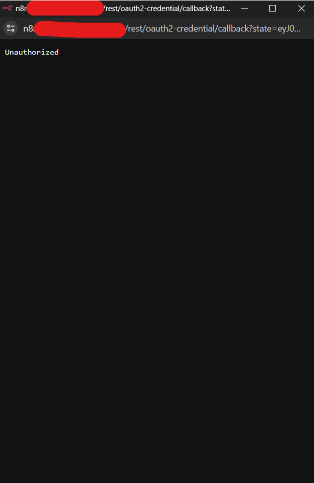

For example, when I try to add a Google Drive credential:
  • I fill out the Client ID & Client Secret
  • I select “Sign In With Google”
  • I select the correct Google account
  • I click “Allow” to the OAuth connection request
  • It returns “Unauthorized” on a black screen (see below)
I’ve confirmed that my OAuth credentials are set up properly on Google’s side (and like I mentioned, I also tried this on non-Google connections, and got the same error). I’ve tried it from multiple Google accounts as well, same result.
I began noticing this on version 1.30.1. I tried downgrading to earlier versions to see if it would fix it (1.30.0, 1.29.0) but the issue persisted. I’m currently unable to update beyond 1.30.1 on the Docker image (I think there’s a bug that’s being fixed that’s preventing me from updating, but that’s a separate issue)
The popup window turns black, with just the word “Unauthorized”. No extra info in the docker log
(This isn’t a specific workflow, it’s when I try to add new credentials. This is whether I do it in a specific node, or on the “Credentials” tab)
“Unauthorized”

Answering my own question again…
I’m able to add new OAuth credentials if I access n8n from my external domain.
When I try to add credentials via my local ip, it fails. But the external url allows me to properly add them.
