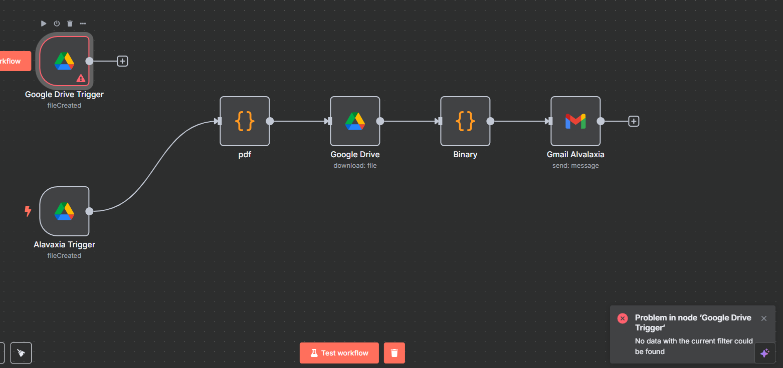

I’m new to n8n, and I created a flow to look at new files created in folders, but I’m getting this error when the folder is empty, and this can happen for some folders, how could I solve it?
Error: No data with the current filter could be found

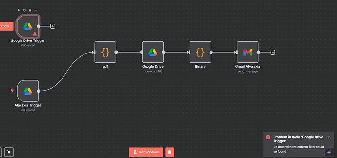

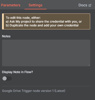

There is no such option in this trigger, my difficulty is precisely this, how do I create a logic to handle this error, if when the error occurs it does not advance to the next step.
Print showing that there isnt option in this trigger
And Workflow:
The fileCreated trigger gets triggered when a new file appears in the folder, so it cannot be empty at the moment the trigger fires off.
If you forcedly trigger the event what you expect n8n to do? It won’t create a file for you to provide you with any test data. It wouldn’t be OK for a reading node to write data, a potential nightmare to debug.
