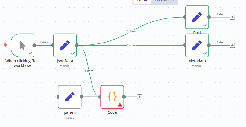

This is my first post here. Im just starting with n8n.
I have an issue in code node.
The input pane on the left show me
“No fields - item(s) exist, but they’re empty” after I test the code node,
However prior testing when I just double click on the node the value is visible.
Is the node not executed because not connected wiith the triger? Well even if I connect it, it does not work.

This approach doesn’t work as expected. The Node param is never executed, and it doesn’t pass the parameters to the Code Node. n8n processes the workflow step by step, moving from the start to the end. If additional parameters are required, a Node needs to be added in between the other Nodes.

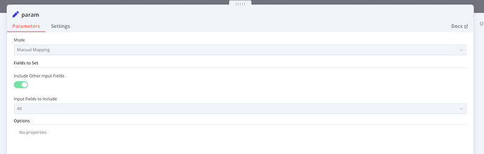

How can i load data from fields in both nodes (jsonData and param) to separate variables in python?

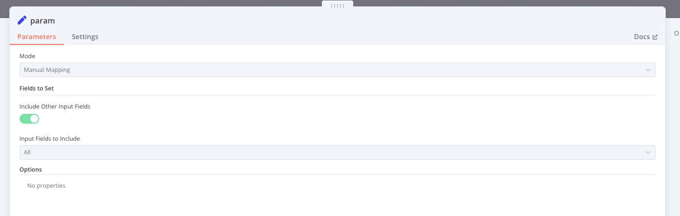

The easiest way is to enable the Include Other Input Fields option on the param node. This will add the new variables to the item.
i was actually asking for the python syntax to input into code node
This is only possible when the param node is connected as shown by Franz. If you connect it like in your screenshot, it never gets executed and you cannot reference the output data in your code node.
Use the “Include Other Input Fields” and access the data from previous node like you already did in your code example.
When Include Other Input Fields is enabled, then data from the node before is passed and can simply be used in the code node.
