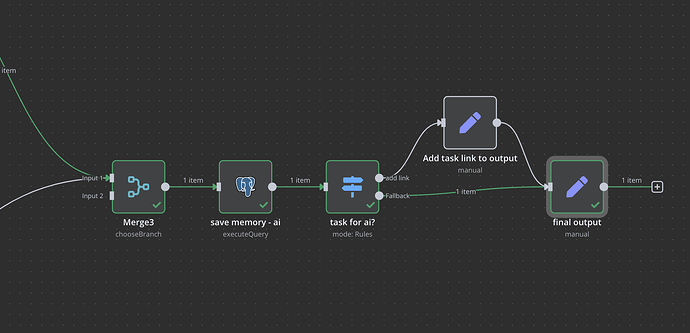

I have a workflow that calls a sub workflow.
The end of the sub workflow is:
Just outputting some text.
But the parent workflow gets the completely wrong response. I tracked it down and an earlier node in my workflow had this:
So… what? Any previous node with output, even if that output is way back at the start of the workflow is then returned to the parent workflow, ignoring any final output from a final node on the child workflow? That seems a bit “silly”.

In the sub-workflow screenshot, the Merge node needs two inputs. Otherwise it stops the flow execution at this point in production.
Also you do need a fallback branch in Switch.

You’ve said the execution stops at the merge node because it needs two inputs… but you can see that it continues execution until the final node, so I’m not sure what you mean.
You’ve said I need a fallback brand in switch. Well, I’m not that I actually need one, but when I do have a fallback on ANY switch earlier in the workflow, the parent workflow receives that output (from the fallback) and not the output from the final node which is why I tried turning off the fallback but the result was that the parent workflow only received a NULL output from the child workflow.
What do you see in wf execution tab on terms of execution sequence and data passing through?
This is possible if neither condition matches and fallback is not connected to anything past it.

That last node perfectly outputs the data I want… but the earlier switch nodes with output going out the fallback output is all the parent workflow seems to care about.
