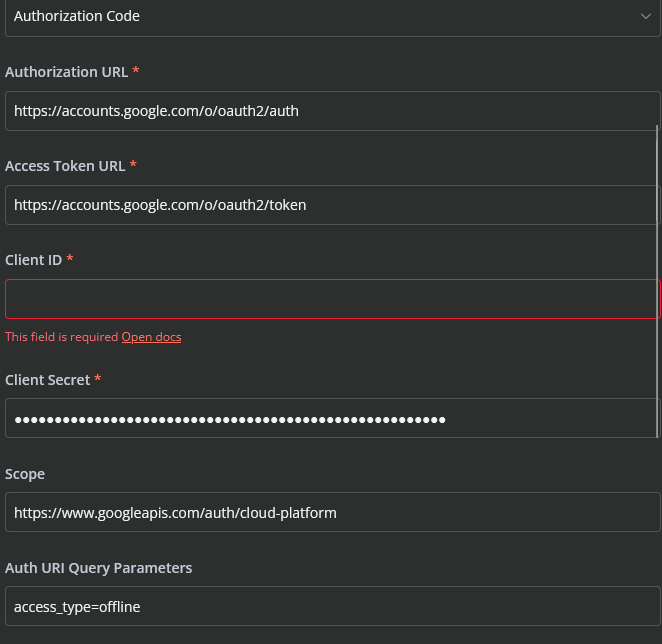

Thanks for a quick reply. I appreciate n8n and all the help. I think you gave me an idea. I basically made a generic oAuth2 for cloud because I read that cloud isn’t supported as a scope.
*I hid clientid
And it didnt refresh.
Yesterday I remade with Google OAuth2 credentialsfrom n8n and added cloud-platform as a scope anyway and it seems like it’s okay and working .
What did I do wrong with the generic one? Screenshot attached
The access token url we use is https://oauth2.googleapis.com/token and for the authURI we use access_type=offline&prompt=consent other than that assuming you are using body as the type it should be good.
Remade with Google OAuth2 credentials from n8n (rather than custom) and added cloud-platform as a scope. Also @Jon provided a direct solution to my question. Thank you
