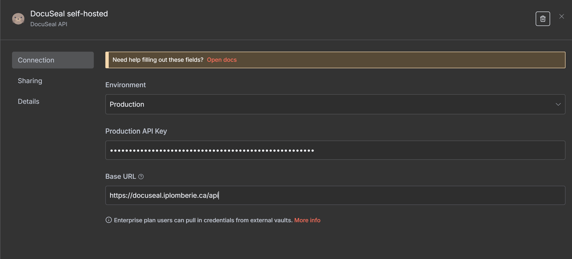

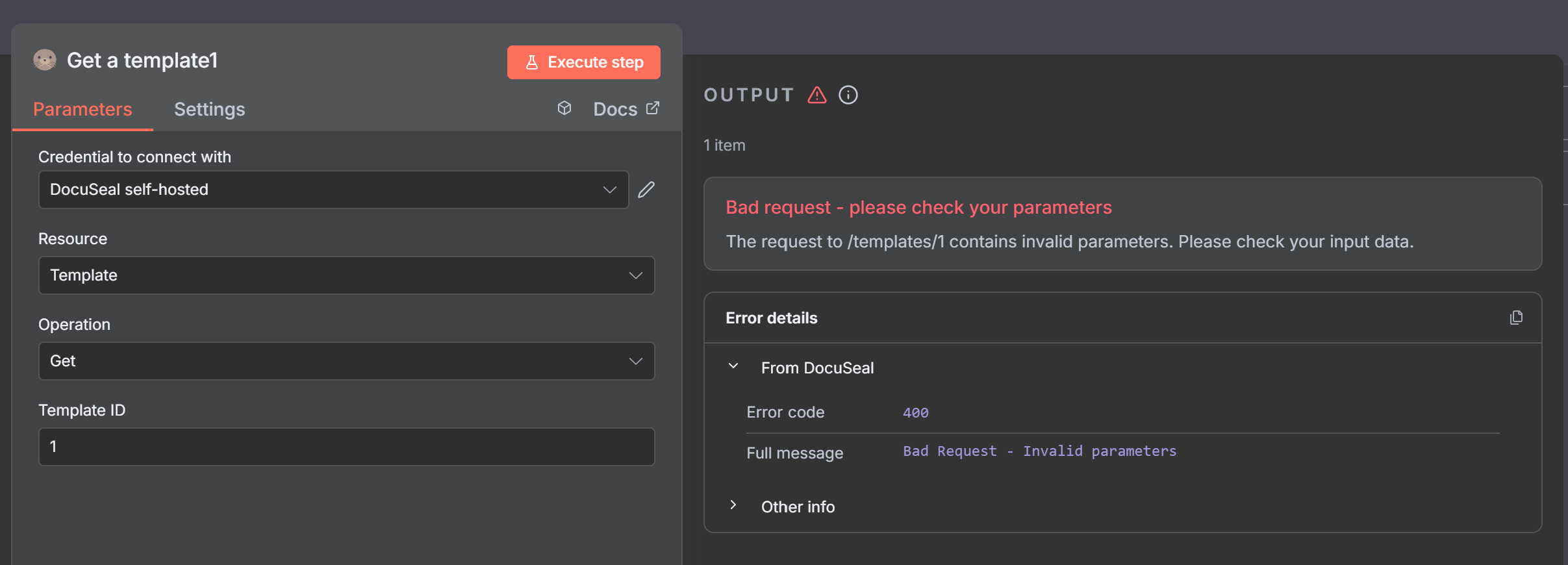

Hi @serkan, I used this node with the cloud version of Docuseal without issue. Now that I started self-host Docuseal, the nodes does work anymore. I changed the base url for my selfhosted api. (https://docuseal.iplomberie.ca/api). If I call https://docuseal.iplomberie.ca/api/templates/1 you can see that it respond (not authentificated in your case) but in mine, with the proper header with an n8n http request, I get values.
If I use the predefined credentials configure with the base url and the key and try to get a template from the list, we can see that the list is empty (bad sign already). If I use the id hardcoded, i get the error (see the picture).
