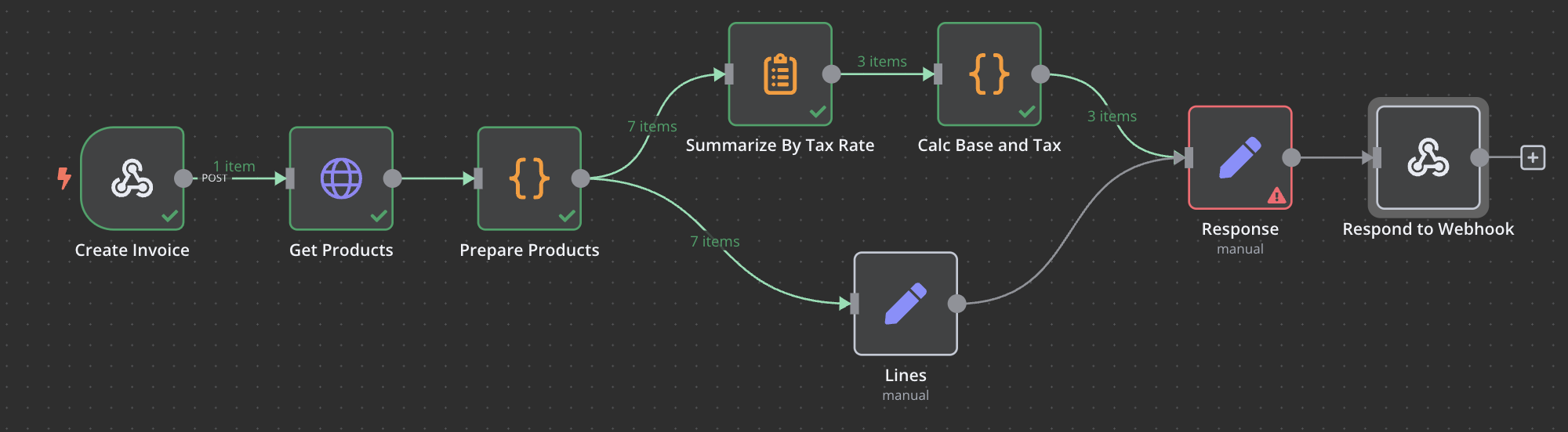

I have this workflow.
I make two parallel calculations.
  1. I calculate the tax
  2. I transform the data for listing the products on the invoice
The response node is intended to summarize the results of the two calculations. The problem is that the response is not waiting for the second calculation to be completed. I got this error in the node
NodeOperationError: Referenced node is unexecuted at Object.execute

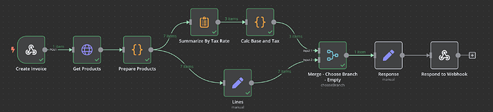

Working example
If I add a merge node, it works.
I’m just wondering why I always have to use a merge node to wait until all branches are completed to continue execution. It should be clear from the sequence that you have to wait until all the nodes have been executed.
That is not yet so clear to me
hi @Tobi
Welcome to the community! I had some doubts around node execution order as well in the past but they have it documented here: Execution order in multi-branch workflows | n8n Docs
The advanced video course also speaks about this execution order with some examples: n8n Advanced Course (1/8) - Working with complex data flows
Hope this helps!
