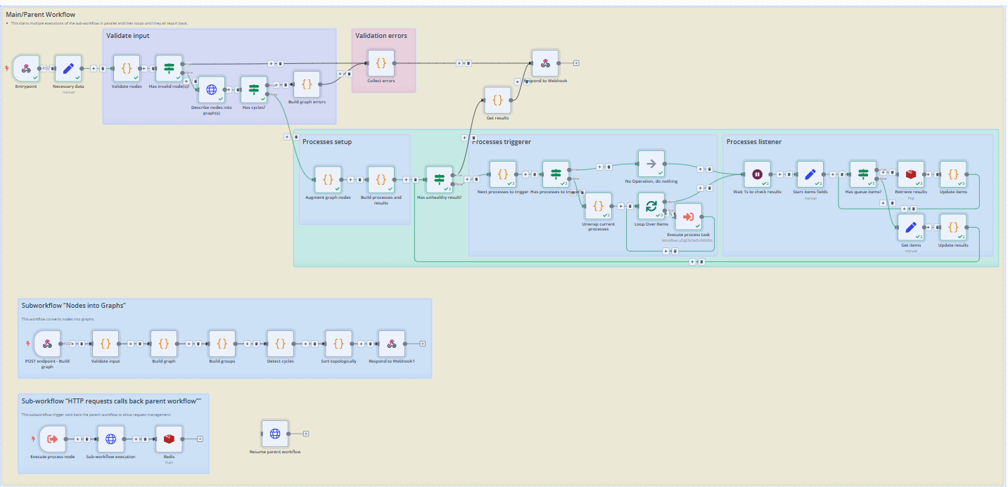

I pursue a way to perform parallel operations with N8N. So far, I know a @hubschrauber’s version, with wait node on callback mode. His approach is flaw-prone because the interval between node trigger and reactivation may have callback requests.
My implementation follows a redis approach: I implement redis storage of process results readiness (For now, it saves the result as well, but we can improve it latter for medium-sized payloads).
I pasted both big and minimal examples, as well as a example workflow to be triggered: the parallel manager workflow fails to trigger a Sub-workflow loop (also fails to trigger item by item when I set the node “Execute Sub-workflow” to execute for each item, without loop).
You can test with command below. Firstly copy-paste and activate, separately, both workflows for requests management and get-post workflow, both available on section ‘Please share your workflow’.

Below an image of the workflow in its full glory:
Since the workflow is really big for this text field, I stored it on github: https://raw.githubusercontent.com/alloyha/assets/refs/heads/main/n8n/parallel_manager.json

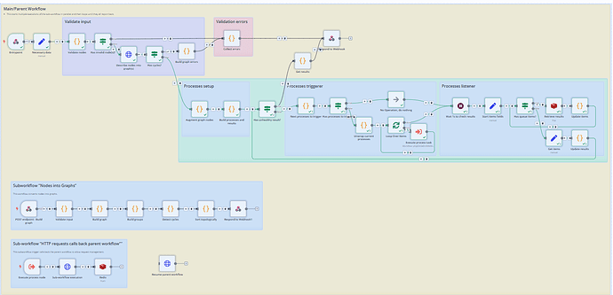

I also implemented a minimal example with the same architectural logic, but it works as I expected for my demay:

my point of view, the problem in the input data to the loop node…
I try to change the structure of the input data of loop and its working and execute all the iteratiosn
check this one:
