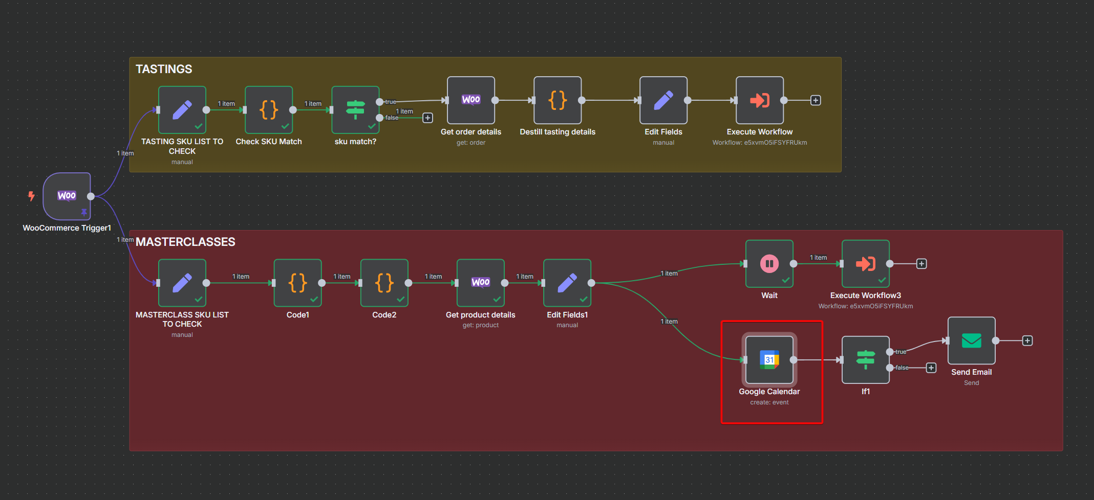

When executing my workflow, the “create Google Calendar event” is not executed.
I don’t even get an error message.
When executing the nodes individually 1 by 1, the “create Google Calendar event” executes without issues.
No error message

This happens because the Execute Workflow3 node doesn’t produce any data, which may happen if the subworkflow either errors or doesn’t return any data. What subworkflows execution says? Any errors there?

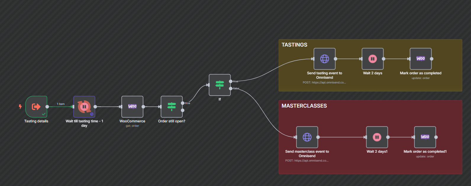

No errors there, but the subflow has a waiting node tha needs to wait for quite a while.
Here is the SUB workflow:
One option is to set the Execute Workflow node’s mode to not to wait till subworfklow completion.
If this resolves your issue, please mark this post as a :white_check_mark: Solution.
Awesome, that did the trick. Thanks a lot for your quick help man!
Glad it worked!
As a side note, I wouldn’t rely on that long waiting periods. It may not work as expected. More reliable way is to keep registry of scheduled events and execute actions based on status.
