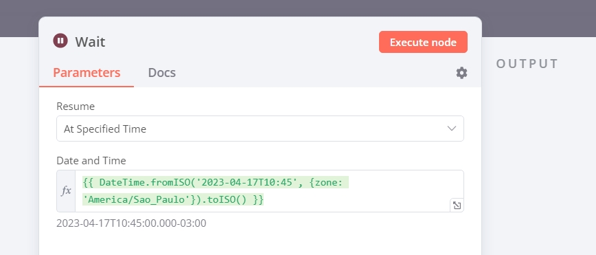

Can you maybe try an expression instead in the wait node to ensure you’re manually setting the timezone? For you that would look something like this:
{{ DateTime.fromISO('2023-04-17T18:45', {zone: 'America/Sao_Paulo'}).toISO() }}
Can you let me know if that does the trick? Obviously you’d need to set that date to what time you actually want to run it at :sweat_smile:

Even using the expression, the Wait node keeps adding + 3 hours to the scheduled time. :frowning:
This issue is occurring in n8n queue mode. If you have an n8n to test with, that would be great.
In n8n regular mode, this problem does not occur.
