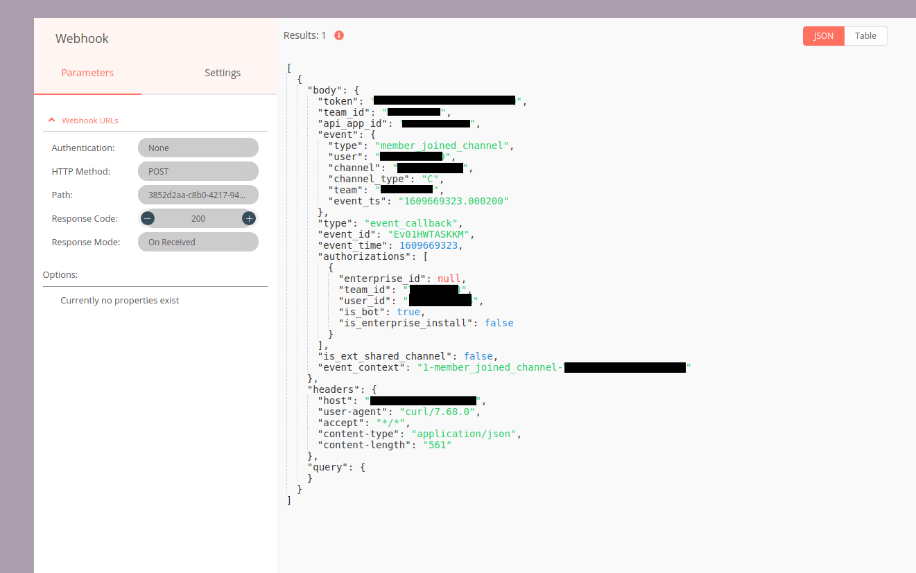

So the Webhook-Node displays the little green “1” in the corner and it for sure has the body you are referencing? Can you please post a screenshot of the Webhook-Node with JSON selected.
If you look at it you can see that the data underneath body is not a regular object is it some very messed up one of which the most data is the “key”. The easiest way to spot that is that all the data is in one line instead of multiple ones.

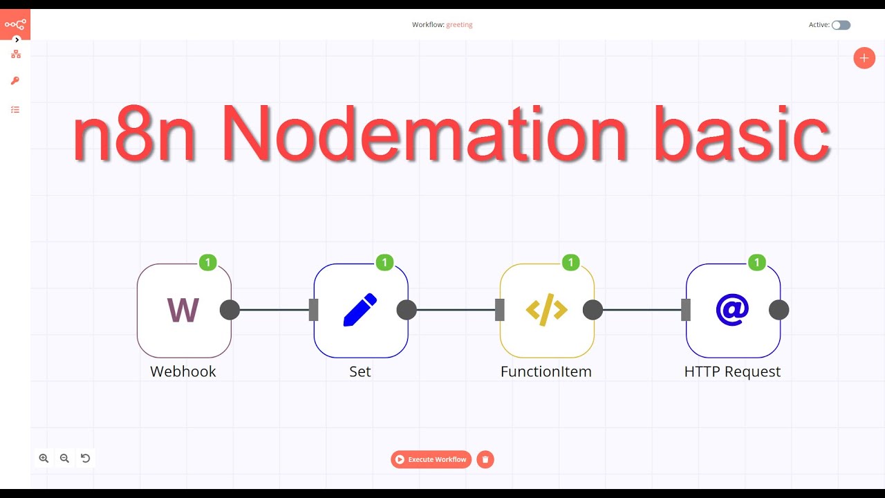

You can look at this tutorial where it does exactly that. That makes it probably clearer:
Damn, I should’ve watched the intro tutorials. Apologies.
