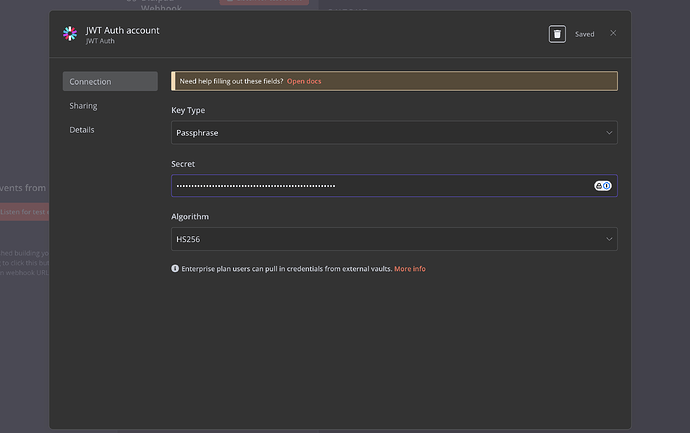

hi @dmeledones
Just made a simple test with your node and it’s properly recognizing the signed JWT once I added the proper secret to the configs:
What steps have you taken so far to configure the node? Do you have the correct secret?
This is very interesting. I did configure JWT as shown in your screenshot and I do believe the secret is correct. I even changed it on both ends to a single word passphrase and confirmed with jwt.io that it updated on the sending side. Is it possible to view the secret in n8n? I tried pasting it and typing it but I have no way of knowing if it is somehow becoming corrupted.
As this is a new install I have destroyed the VM and will try again with a fresh setup soon, hopefully today.
