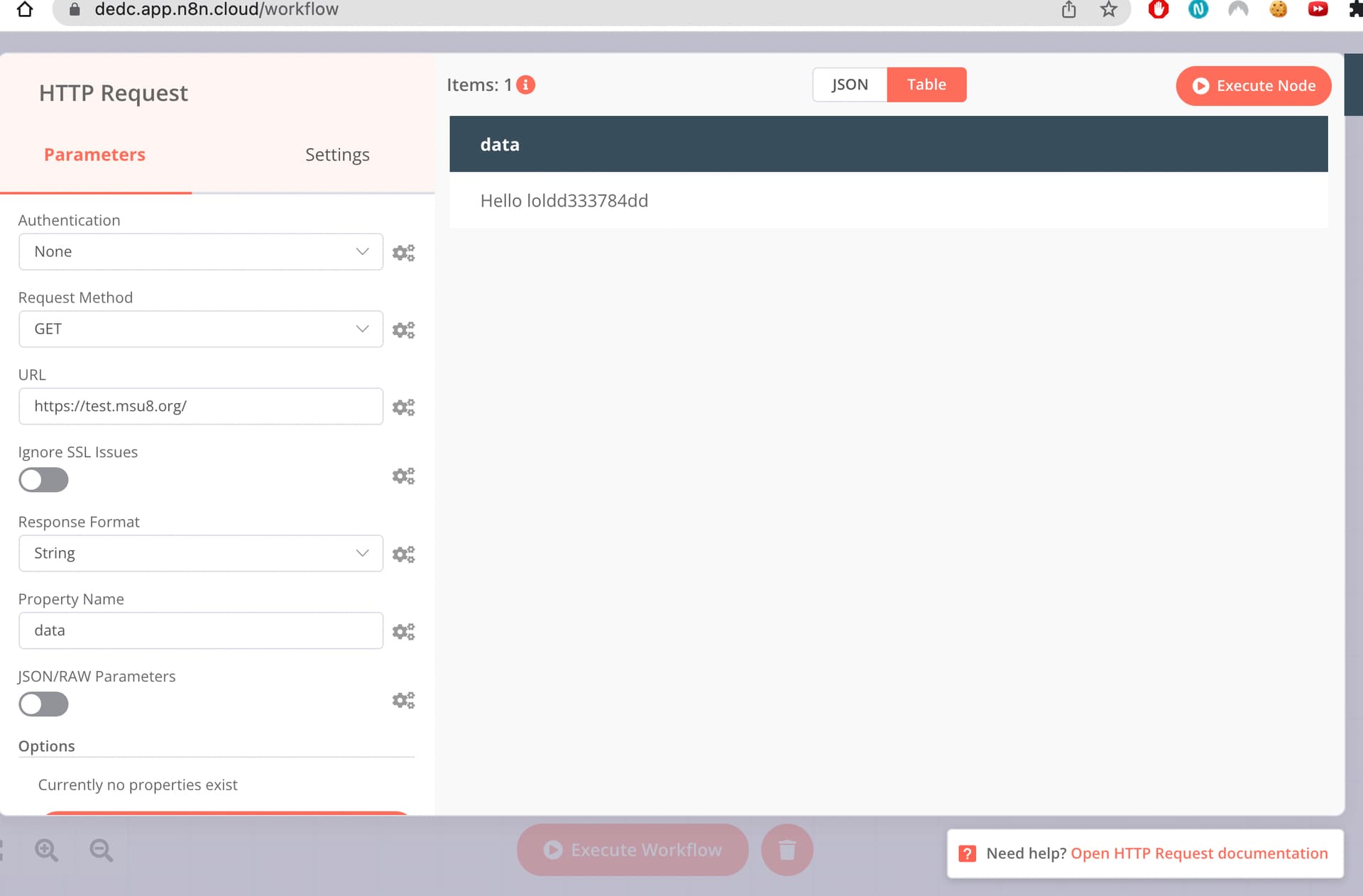

Thank you for the ansver. But i have a problem, than nothing executes on my server. ANy button i push(execution related) and they just load…
Take a look. That how it is supposed to work (Cloud n8n)

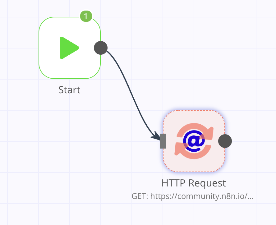

My update:
I managed to make it work on https, but still get freezes after lanuching any action(while on https protocol) Like it can’t communicate with backend with mixed content warnings.
Take a look : (Maybe this behavior of docker / application / ngix will tell you something)
I accidentally noticed this anomaly: Loom | Free Screen & Video Recording Software recorded a video.
I comment: in the application, as a standard, I press execute a cube (get request, for example) while the https protocol is enabled - it hangs up as always.
But!! , if at this moment you update the nginx settings (if you press save & update in the console, then the caprover reloads this docker instance and nginx settings), then the REQUEST WILL BE FULFILLED!)
Then, of course, 10-15 seconds error 502, the container is loaded. And again you can refresh the page and it won’t work when you push it.
Maybe you have any suggestions what this might be related to?
