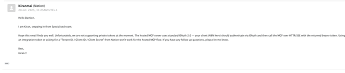

I asked the Notion team but here’s their reply

Unfortunately it’s not yet possible to use an MCP server in n8n that relies on OAuth authentication like the one from Notion does.
Luckily it seems the team has finally tackled this shortcoming and the feature was merged 3 days ago in this pull request: https://github.com/n8n-io/n8n/pull/21034
