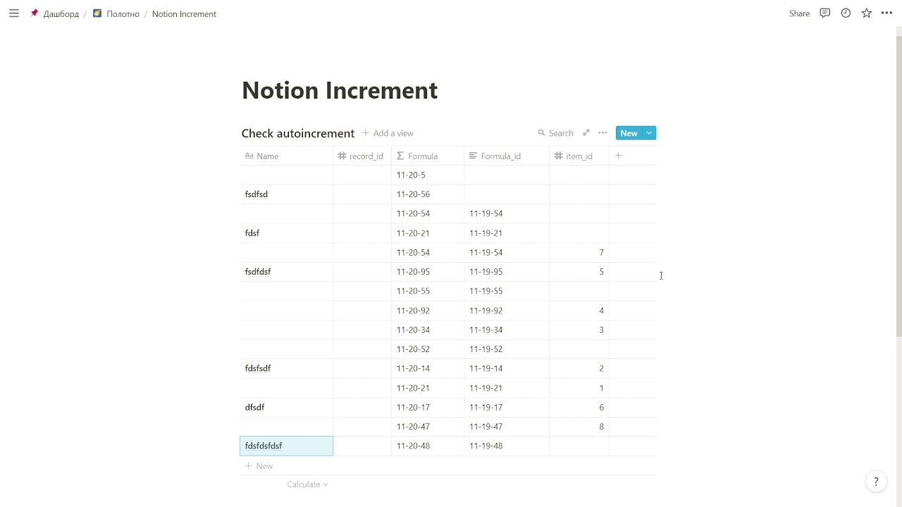

So far I know for sure one thing. Notion trigger MAY NOT catch all the new items. I run many small experiments. And when added multiple rows, some of them were not processed.
Like here. They were added in a couple of seconds
Another case. I think, it’s some edge cases either for notion timer of for n8n timer

Please take a look, 2 records are not processed:

Another test also gave one unchanged record, whose timing was on the edge, I guess
Here is the Notion page I worked with:

@RicardoE105I I seem to find the problem. If the trigger fired at some minute, it won’t fire in the rest of this minute, if new records added. You can see that I added some data in the same minute the process started. And it just didn’t see the new data (red rectangles). When I waited, it was fine (green rectangles)

I think, yes — the errors happens not always, but when happened I saw this difference in updated time.
