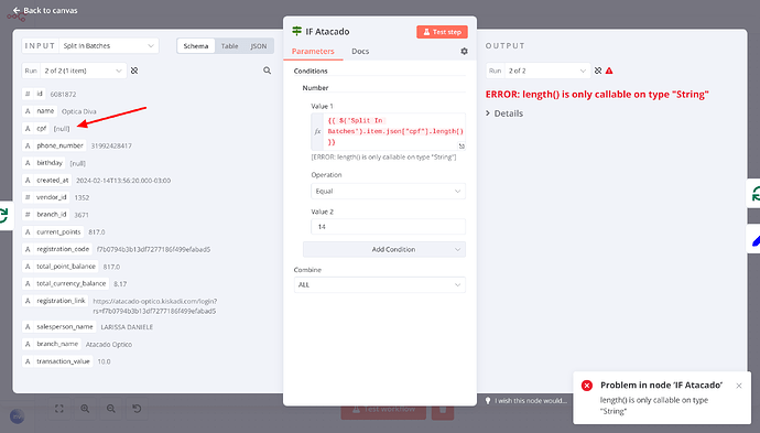

Using an HTTPS node, I get a string value called “cpf” that is normally 11 or 14 characters long. The number of characters indicate the type of customers: 11 chars is a person, 14 chars is a business.
The rest of the worflow depends on whether the customer is a person or a business, so I added an IF node, where I use the formula .length(). For exemple, using length(), “85342386004” is 11 chars (person), “14860895000193” is 14 chars (business) and i compare that value to 14.
The problem is that when the value of cpf is Null, the length function returns an error instead of returning zero:
Any sugestion to handle the null case?
