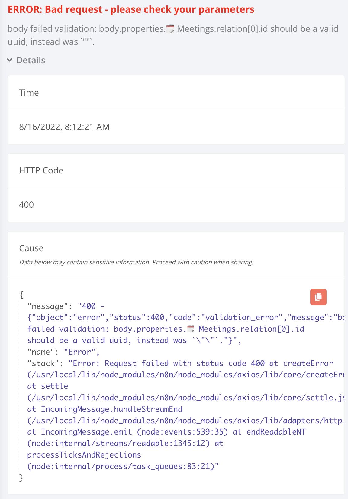

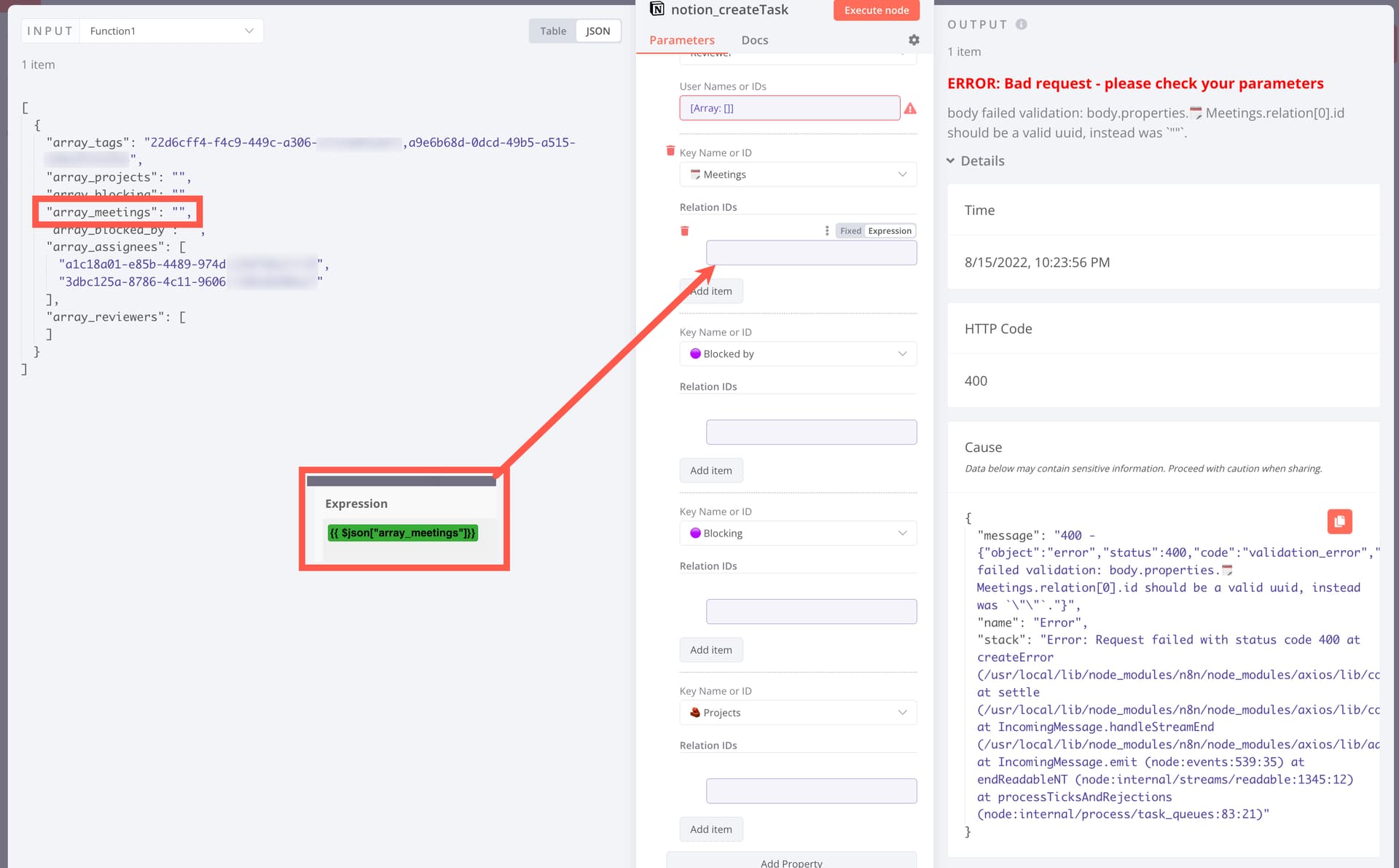

Re-opening this issue to extend to the case of database relations:
If, as shown in the image above, you pass an empty value into a relation, it causes an error.
Note that this is necessary - the workflow I am building will not know in advance which properties will be needed to be added to the Notion Database page.
Is there a way around this issue?
I have also tried @jan’s method of:
{{$json[] || null}}
but as established above, null doesn’t seem to work anymore with notion

What happens if you just don’t include that field? Does it still fail?
Getting the same error, I’m afraid when left blank.
I suspect (although I could be incorrect, and there could be a way of preventing this) that when you hit Add Item, this creates an object for this database field in the POST request, and therefore, no entry causes an issue. Hopefully, there is a workaround, but if not, perhaps the notion node could be updated so that if there is nothing in the relation field (as above), then no object is generated?

Ah no so I did have the meetings field - it was just blank (nothing inside)
It does work fine if you delete that field, but I guess that the point is for it to be filled variably based on the input and if it’s deleted altogether no dice.

I have have had a play and I can see the issue now, So if you don’t have an input that is a uuid you want to send nothing in that field.
It looks like when we handle the relation field we do a split and that looks to be failing so maybe we just need an “empty” option.
As a workaround what I would do is just pop an If before it and if the incoming field is empty go to a second notion node that doesn’t have that field set or add it to a list to be manually checked and if it set populate like normal.
