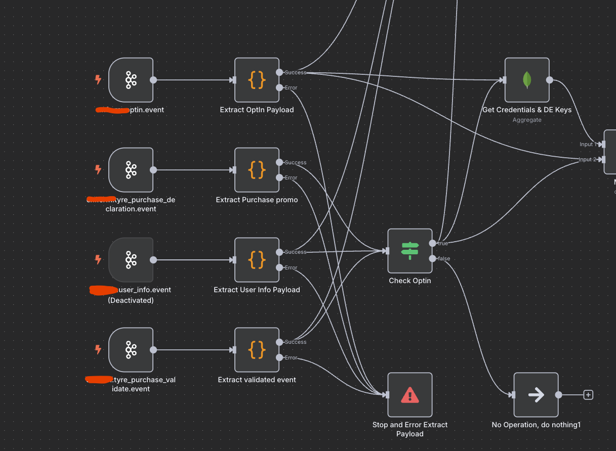

Maybe a screenshot is better that try to explain :wink:
Each KafkaTrigger have his own groupid (maybe i did not express myself correctly in my previous message.)
Thank for your answer, we’ll try to define one KafkaTrigger node by workflow and use an Execute workflow node for the next steps.
