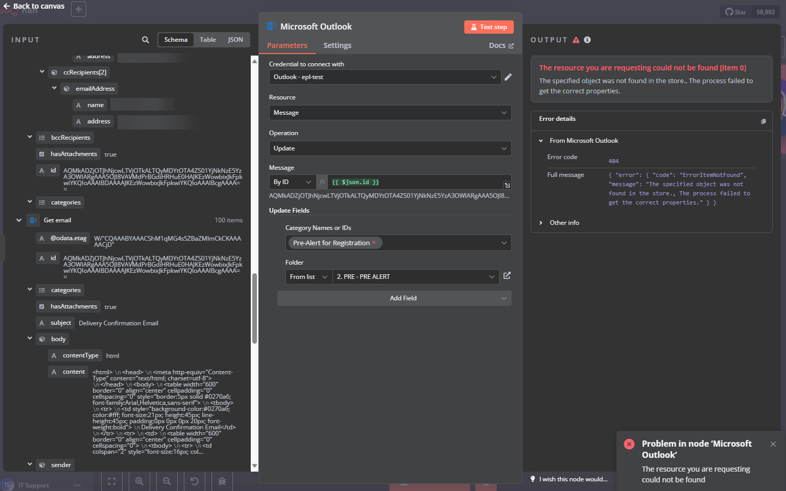

Hi,
So I have gotten to this point where I am trying to assign a category and move the email to another folder. But I am getting the below

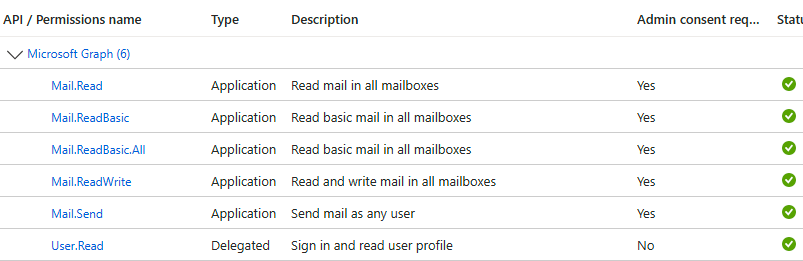

These are my API permissions
I think the issue was using a shared mailbox. It was looking at the owner, not the actual shared mailbox. So I authenticated with the actual mailbox and is now working by the looks of it
