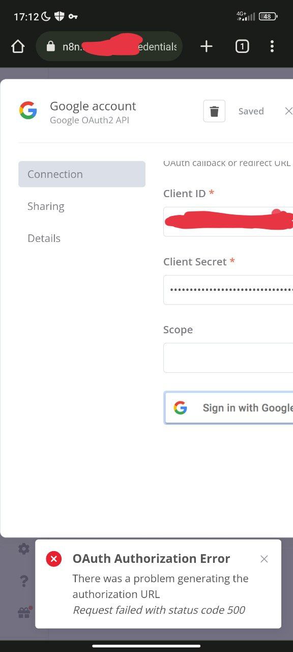

Hi. I have a very rare problem with the OAuth.
I’m trying to connect to an OAuth account (doesn’t matter what account), and get the title error:
imagen
The point is that this error only occurs on my computer. Not browser, computer. I tried with 3 different browsers and get the same error, but I tried on another computer and works fine…
Can anyone have any idea of what can be happening??? I’m going crazy because I can’t create new credentials using my computer…

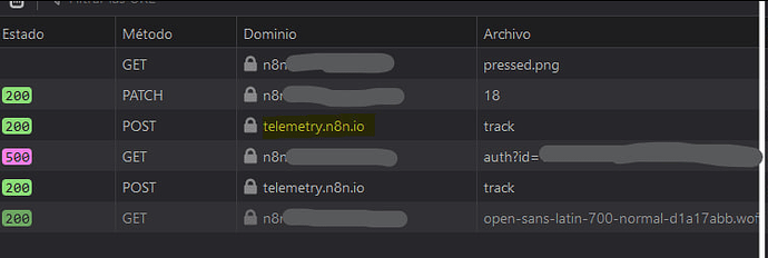

Non-working
The process not works (return error 500) on the next situations:
My personal computer
  • Personal network (home network)
  • No firewall, no VPN or nothing about network monitoring. Basically free access to all.
  • Browsers: Firefox (main browser) and Chrome. I installed Opera (fresh installation) and get the same error message
These are some logs from Firefox
I marked some differences between my other computer.

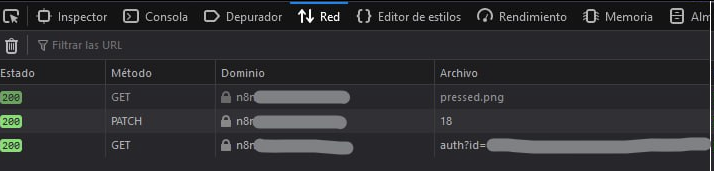

Working
The process works on the next situation
Work computer
  • No VPN, but can be filtered or monitored by a firewall
  • Browsers: Firefox (main browser).
Here are some logs:
