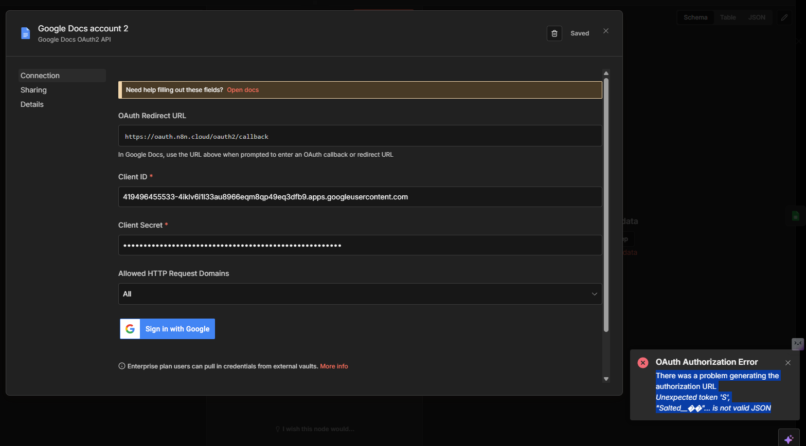

i am having issues with OAUTH with google docs, i have checked it multiple times, everything is correct, but its says this:
There was a problem generating the authorization URL
Unexpected token ‘S’, "Salted__ "… is not valid JSON
Please help me >-< thanks
I have encountered this now, and also i went and tried to check with google sheets as well, when i press on sign in with Google it says exactly the same (but i had already signed in tho) idk why this happening
