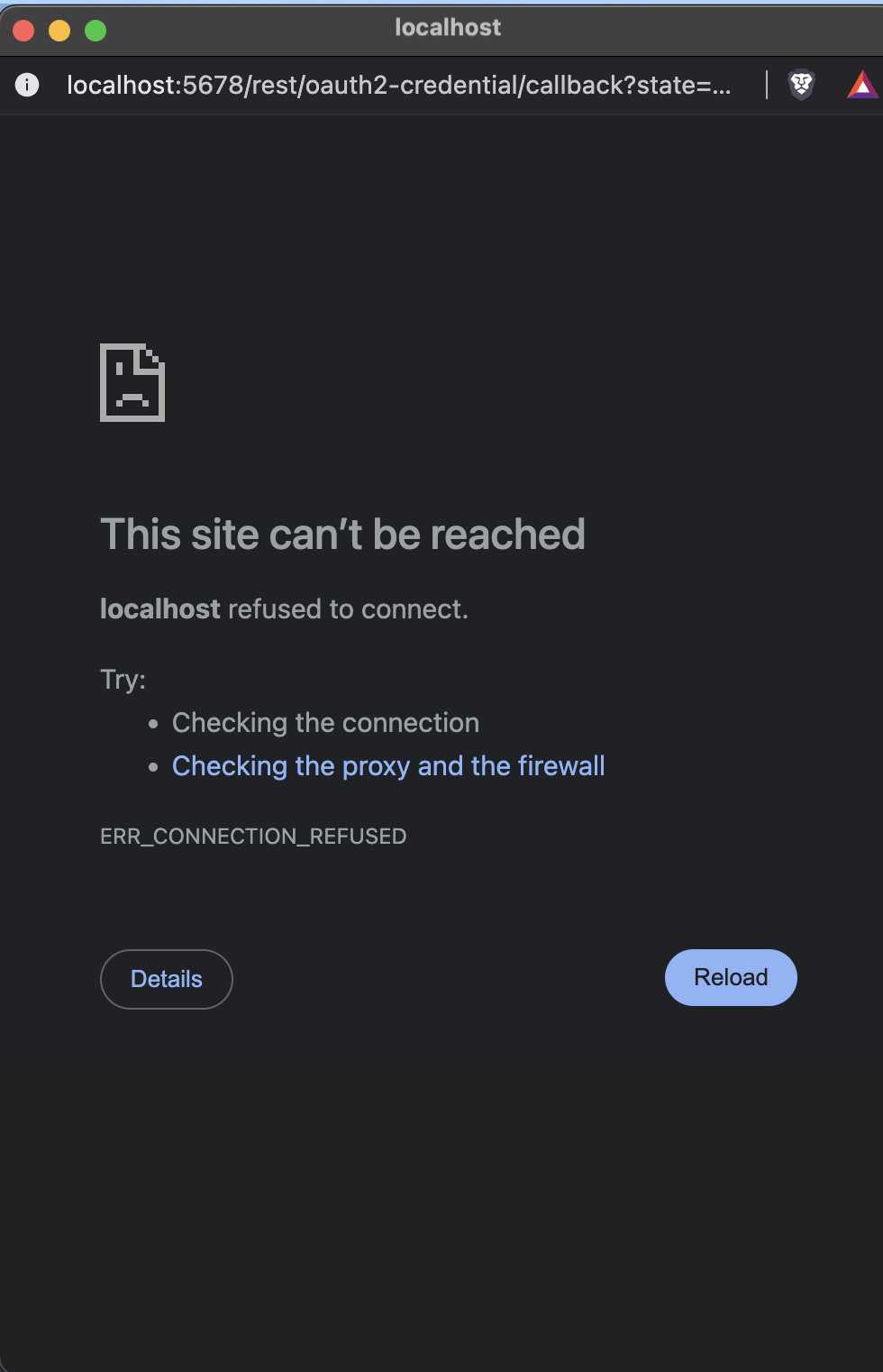

trying to connect the google api to my n8n workflow and it requires to connect it using OAuth after configuring the OAuth on my GCP and input the details of the callback link from n8n, the link is not accessible.
This site can’t be reached
localhost refused to connect.
ERR_CONNECTION_REFUSED

after running this command, n8n is accessible on my browser but I got some issue with regards connecting to google api which is the Callback link from n8n so I end up to post new topic to ask some help…
Issue
Http://localhost:5678/rest/oauth2-credential/callback is not accessible

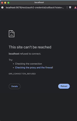

hello dear friend , i’m new , and i’m facing the same problem the acces to google drive the call back , i will share some screen shot and if someone can help me out cause i’m stuck ,

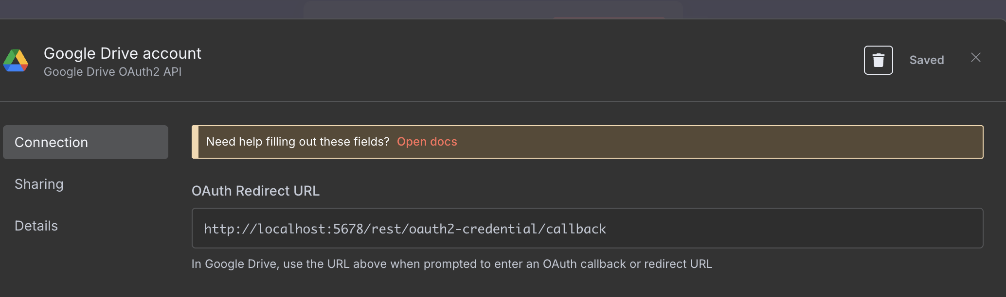

When setting up OAuth locally in n8n, I found a small trick to get it working with HTTP.
  1. First, create the credential with https.
  2. Then immediately edit it, remove the s so it becomes http, and quickly click Done.
  3. Save the credential, and it will stay as HTTP.
This way the connection works for local environments. It’s a bit funny, but it works.
