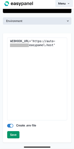

I found a reliable nocode system to solve this problem.
Install Easypanel on your server (you can do this with no coding on Digital Ocean). That makes it easy to install n8n.
Then use Easypanel to install Authotizer (from https://authorizer.dev).
Once you enter your Google oauth2 ID and key, update your webhook url in the Easypanel environment panel:
