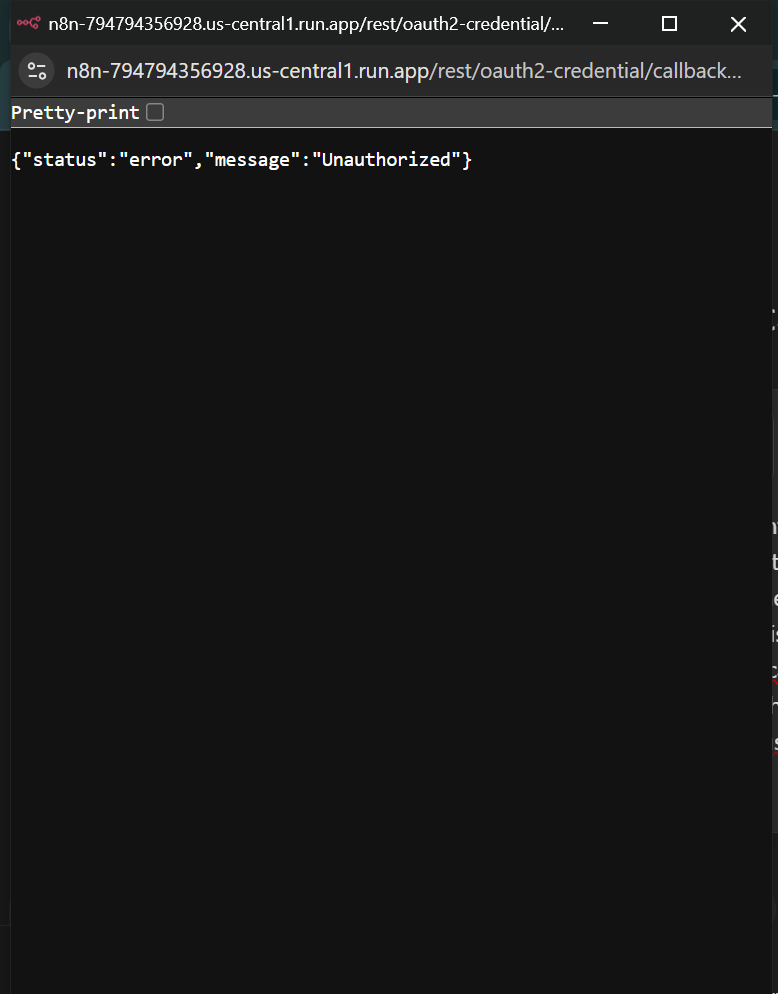

I’m running self-hosted n8n on Google Cloud Run and trying to integrate it with Google OAuth to authenticate and access various Google APIs (e.g., Google Drive, Google Sheets) and trying to create n8n credentials and potentially using those credentials in n8n google nodes like google docs, spreadsheet, drive, etc. I have set up OAuth credentials and the OAuth consent screen in the Google Cloud Console. However, when I try to authenticate with Google via n8n, I am prompted to choose my Google account, where I choose the same account using which I created the credentials and after doing so, I encounter the following error message:
{ “status”: “error”, “message”: “Unauthorized”}

Error Message:
  • After entering the Client ID and Client Secret from the created Oauth credentials, when I click “Sign in with google” in n8n credential, and follow the steps, I get the error message:

Hello @devuser2!
I found that the Google OAuth flow on Cloud Run was failing with Unauthorized simply because Cloud Run was not allowing unauthenticated requests, so Google could not reach the callback endpoint at all, and once I enabled public access and made sure the callback URL in my Google OAuth client matched exactly the one shown by n8n, the authentication flow completed normally.
This is almost certainly a Cloud Run session issue — the container loses your login session between when you click “Sign in with Google” and when Google redirects back to the callback URL, so n8n thinks you’re not authenticated. Add N8N_SKIP_AUTH_ON_OAUTH_CALLBACK=true as an env var in your Cloud Run service config and redeploy, that should fix it.
