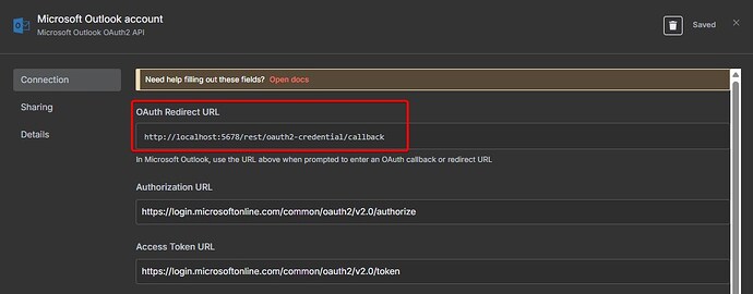

I need to make a new Microsoft Outlook Oauth2 API Credential.
I have successfully type-in the client ID and the client secret. I notice that the OAuth Redirect URL pointing at “http://localhost:5678/…” (the default URL for n8n community edition).
I also have configured the Azure App Registrations - Redirect URLs , using my endpoint domain name (Reverse Proxy). In the image below, I change my real domain name with “n8n.mydomainname.com”.

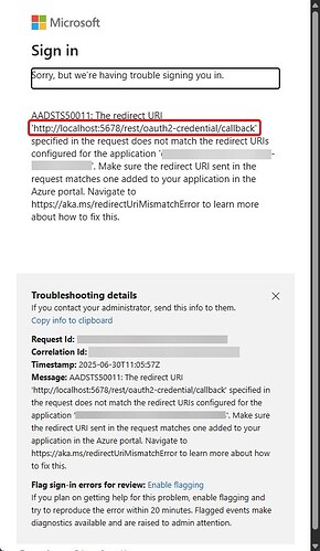

I got this error message when I tried to “Connect my account” in the Credential dialog.
I have tried to change the “localhost” using the .env file and/or using the config file, but not working.

Hello @bagus88 ,
This error is telling you exactly what’s wrong! The redirect URI you’re using doesn’t match what’s configured in your Azure app registration.
The Problem:
  • Your request is using: http://localhost:5678/rest/oauth2-credential/callback
  • But this URL is not registered in your Azure app’s redirect URIs

Thanks @mrrobot for your quick response.
I also have tried to do as you suggested.
For your information, I am accessing the workflow editor (n8n community edition server), using the publish domain name (not using the VM’s).
Looking forward for your kindly response, thank you.

The problem is :
I can’t change the OAuth Redirect URL (https://localhost:5678/…) with the "n8n.mydomainname.id (as shown in the address bar of the browser).
The Microsoft Outlook OAuth2 API always displays an error message, either
a. “localhost refused to connect” if I write the exact OAuth Redirect URL in the n8n MS Outlook Credential above in the Microsoft Azure - Platform Configuration - WEB Redirect URLs
b. “The redirect URL, specified in the request does not match the redirect URLs configured for the application.” if I write my n8n domain name in the n8n MS Outlook Credential above in the Microsoft Azure - Platform Configuration - WEB Redirect URLs.
I have tried to change the “localhost:5678” configuration, using the .env file and the config file, still not solving the problem.
