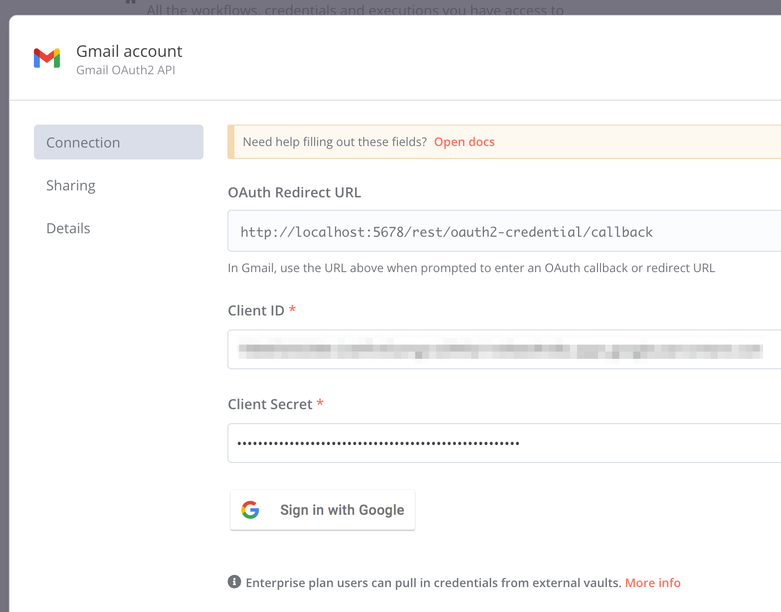

OAuth Redirect URL stuck with `localhost` and consent windows complains on Error 400: redirect_uri_mismatch
Disclaimer: I’ve seen several issues on this problem, but none resolved my problem.
When creating new Gmail OAuth credentials, the redirect URL is stuck on localhost. I can’t figure out why and where is this coming from. :point_down:

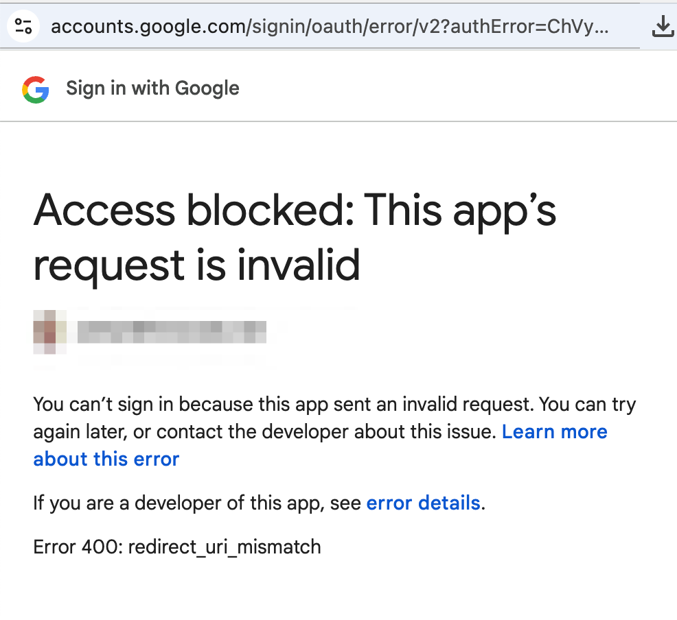

Then on the consent window I am receiving this error Error 400: redirect_uri_mismatch : :point_down:
I’m not sure the two are related, I only suspect they do.

OK - Very strange. After reading this post I went back to Google API config and added the localhost redirection URL.
The immediate result was that the OAuth2 dialogue presented me with my Google accounts (!!!). However once I approved the permissions the process breaks because the browser is then trying to redirect to localhost and this obviously doesn’t work.
So I’m one step forward, but still no solution.

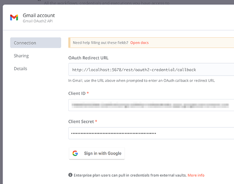

With the variables you’ve setup, the redirect URI in n8n editor should match the domain you’ve setup. Are you sure the env vars are being read/applied?
@hrishikesh I’m sure but then I may be wrong. How should I go on verify this?
If I could use one of the nodes in order to run something like echo $ENV['N8N_HOST] or echo $N8N_HOST then I guess that would be decisive.
Can I ?
That should be possible using the code node: process.env.N8N_HOST
Thanks @hrishikesh. When using process I’m getting an error Cannot find name 'process'. Do you need to install type definitions for node? Try npm i --save-dev @types/node.
Same goes for using $env:man_shrugging:
Problem solved! I’m using n8n’s self hosted starter kit which uses docker-compose.
The variables I have in .env are not picked up by docker unless explicitly adding an -env_file directive to docker-compose.yml
I opened a PR just in case: Include .env in docker-compose.yml by zohar · Pull Request #43 · n8n-io/self-hosted-ai-starter-kit · GitHub
Now it happens in form node… :man_facepalming: :man_facepalming: :man_facepalming: :man_facepalming:
