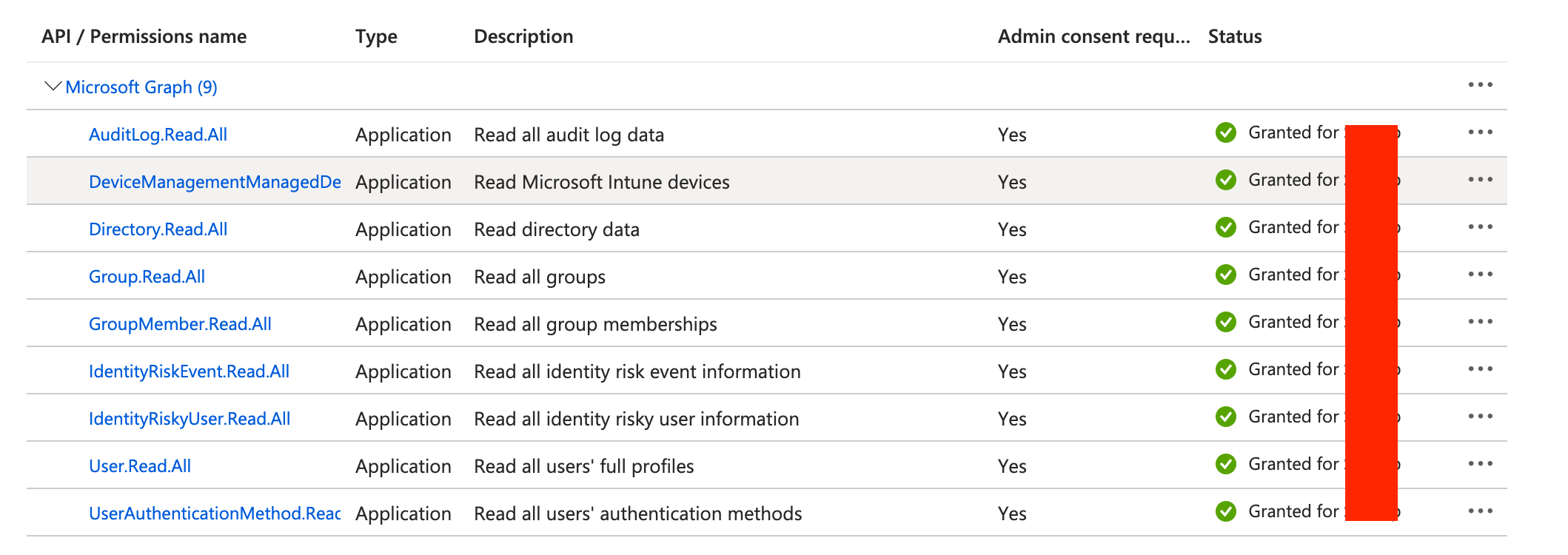

I am trying to read info through Microsoft Graph. I have the Azure app setup with Application permissions for the scopes I need, but I am struggling to get the credentials working in n8n.
I think I have everything according to the documentation:
n8n Oauth Credential settings:
Scopes for the Azure App

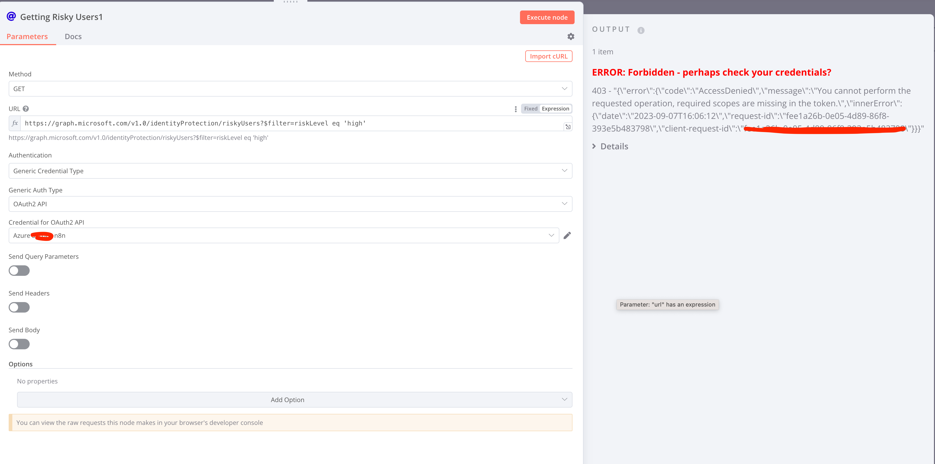

HTTP request for risky users - requires IdentityRiskyUsers scope:
According to the error it seems like a problem with scopes, but according to the docs https://graph.microsoft.com/.default should give it all the scopes from the app.
I tried the same credentials via python and it all works fine.
Anyone could help (for example @pemontto according to a different post have it working), I am lost at this point.
Thanks
"403 - "{\"error\":{\"code\":\"AccessDenied\",\"message\":\"You cannot perform the requested operation, required scopes are missing in the token.\",\"innerError\":{\"date\":\"2023-09-07T16:06:12\",\"request-id\":\"fee1a26b-0e05-4d89-86f8-393e5b483798\",\"client-request-id\":\"fee1a26b-0e05-4d89-86f8-393e5b483798\"}}}""

Hey @tkey,
Looking at that Microsoft is unhappy with the scopes so there is not really a lot we can do, depending on when you created the app and granted the permissions though it might be worth deleting the credential in n8n and adding it again to make sure a new token is fetched.
It could be worth reaching out to the Azure dev community to see if they have any thoughts anyway, I can’t remember if Azure logs reasons for errors in the admin side but could also be worth looking for that.
