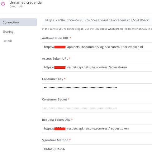

I’ve also tried setting up oAuth 1.0 credentials but I’m getting the below error when trying to connect that too.
OAuth Authorization Error
There was a problem generating the authorization URL Request failed with status code 400
