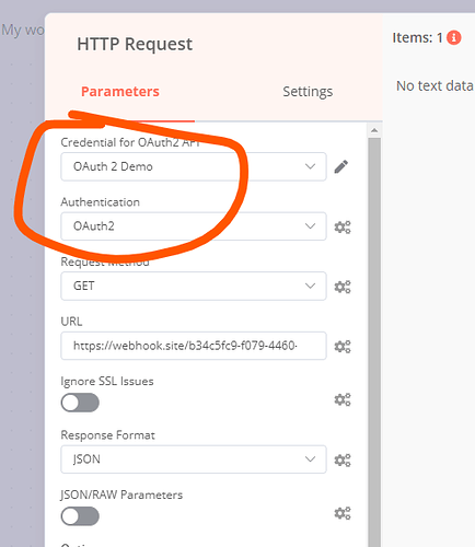

You can still take a look at your token if needed though. If you have configured OAuth2 in your HTTP Request node like so:
Maybe you can share some more information on the service you are trying to connect to, your credentials set up and the node you are using?
You could send a request to a URL provided by (for example) https://webhook.site/. On this page you’d be able to inspect the full request, including the authorization header containing your bearer token:
