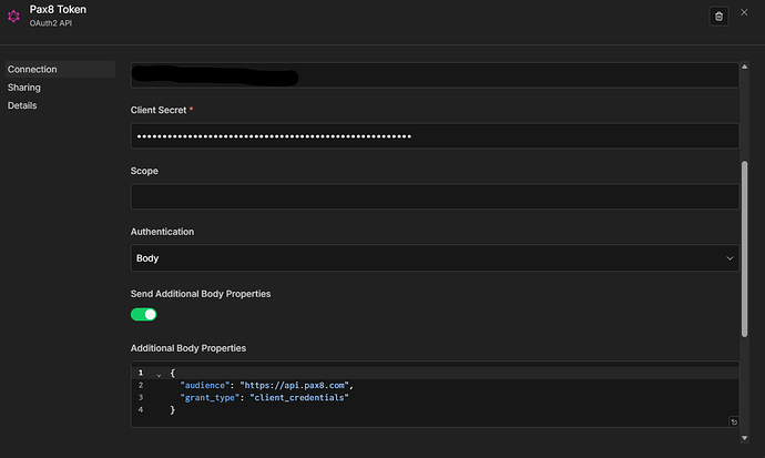

I’ve created an PR which was just merged in that solves this issue. We should hopefully see it in the next release.
Basically, when setting up OAuth2 with Client Credentials, you’ll now be able to add ‘additional body properties’ that would you like to send with the token request such as audience or grant_type.
Hope this enables a lot of people to be able to utilize these third party APIs in n8n that require it!

J’ai réussi à faire fonctionner cela avec Pax8 en utilisant les paramètres de corps supplémentaires avec les identifiants du client OAuth2 API.
