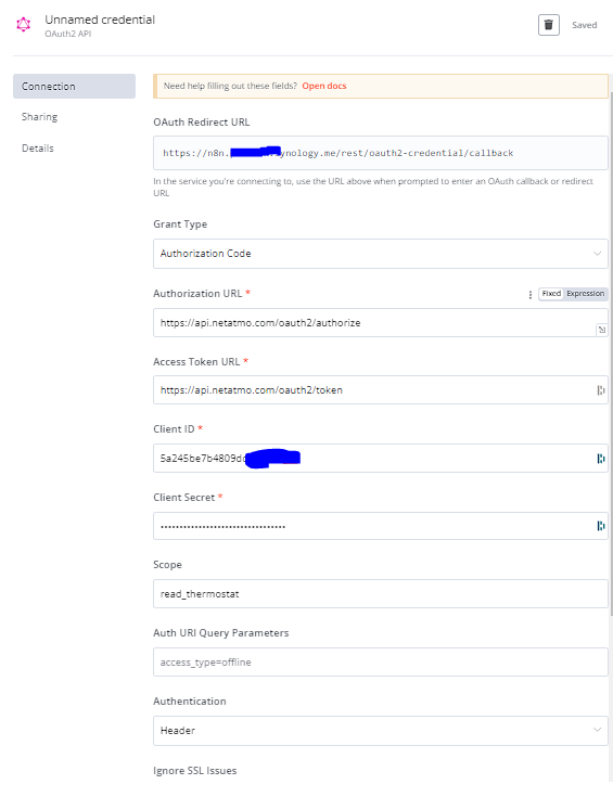

I’m stuck again! I need to create a node to access my Netatmo system ex: weather station.

I have tried using OAuth2 API API credential as follow and I get “Unauthorized” after I get the prompt to connect the application.
What did I do wrong?

I have just set up an account with Netatmo to take a quick look at this and I managed to get it working by setting the Authentication type to Body, Can you give this a go and let me know if it works for you.
Hi @Jon,
Thanks for your answer, Super happy you managed to get it working! I have been spending at least 2 hours… But I don’t undersatand enough authentication to manage to do it by myself here… Sorry!
Yes, it works now!!!
Many thanks, it’s great!
