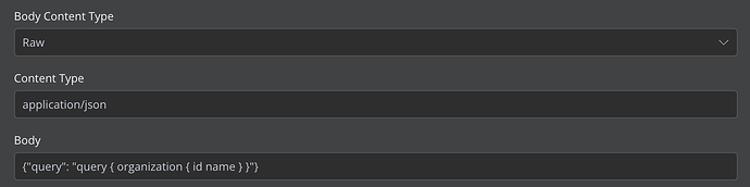

Hi @ThinkBot
I think your authentication is fine but looking at the error it’s probably related to what the API expects from your request body.
Doing a quick google search, it seems that it does expect a JSON, so you need to change that in your node config:
Have a look at the official Upwork Docs to see what it’s expecting to receive
(You can see it’s expecting application/json):

I very much appreciate anyone trying to help but what you proposed was, as I understand it, the same thing I already have with a different selection:
UpWork API did not update within days of setup to usage, without issue, and then 2 days later it failed with what I believe is an incorrect error related to bad OAuth, as it so extremely general, and my UpWork API call was working and correct, including the client testing via curl.
I will most likely bump this once we are back in the office testing some other theories out with the client.
We will most likely just end up making manual oauth token refresh requests, but that seems so unnecessary.
@ria
just to confirm I wasn’t thinking weird. I in fact tested with your suggestion, and as expected, the same outcome, which I am confident is unrelated to the request and is related to the OAuth connection.
