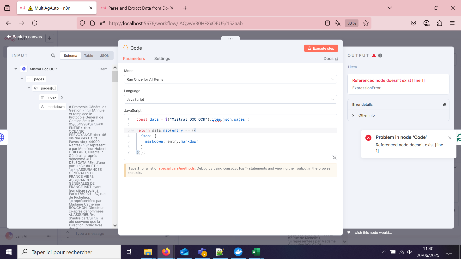

Dear,
I follow this template to use OCR to save data on Vector Store,
On the node “Code”, i get message error:
Where is the problem please? What is the equivalent python code?
Of more, i need to use Http request to use OCR before save on VectorStore or there are Nodes can be use to detect characters by OCRs?

Hey @jamal ,
Try to replace the first line of code with the following:-
$("Mistral DOC OCR").item.json.pages ;
and the run again, and let me know if it works or not .
I set your line:

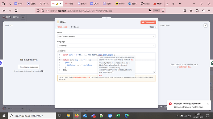

Hey @jamal , yes yes it will show that red line in code but no worries it does not affect anything.
Please try to run this and add a trigger node before starting the workflow as I am able to see the error you got now is because you have not attached trigger node before running this node.

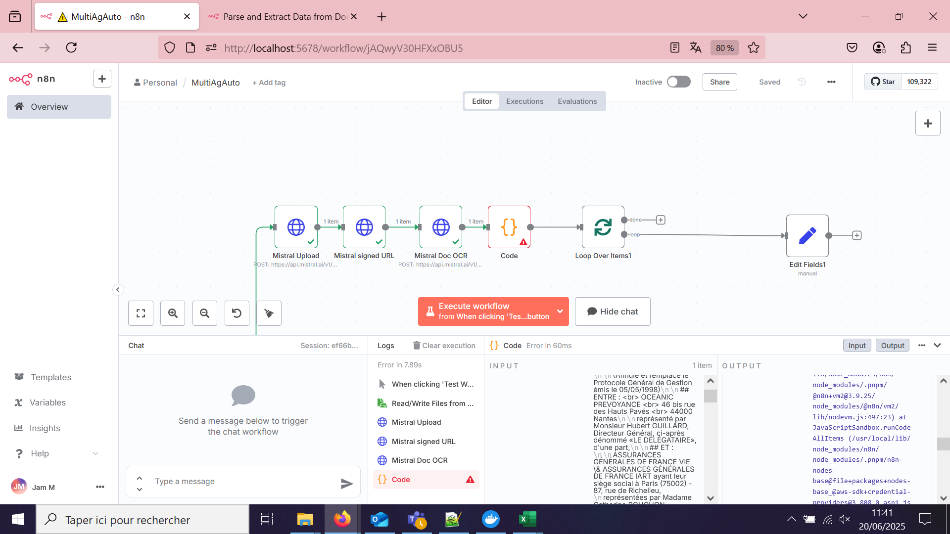

Dear, i get this message:
Hey @jamal ,
Let’s do one thing. Please share the 2 nodes with me, let me have look at my side.
